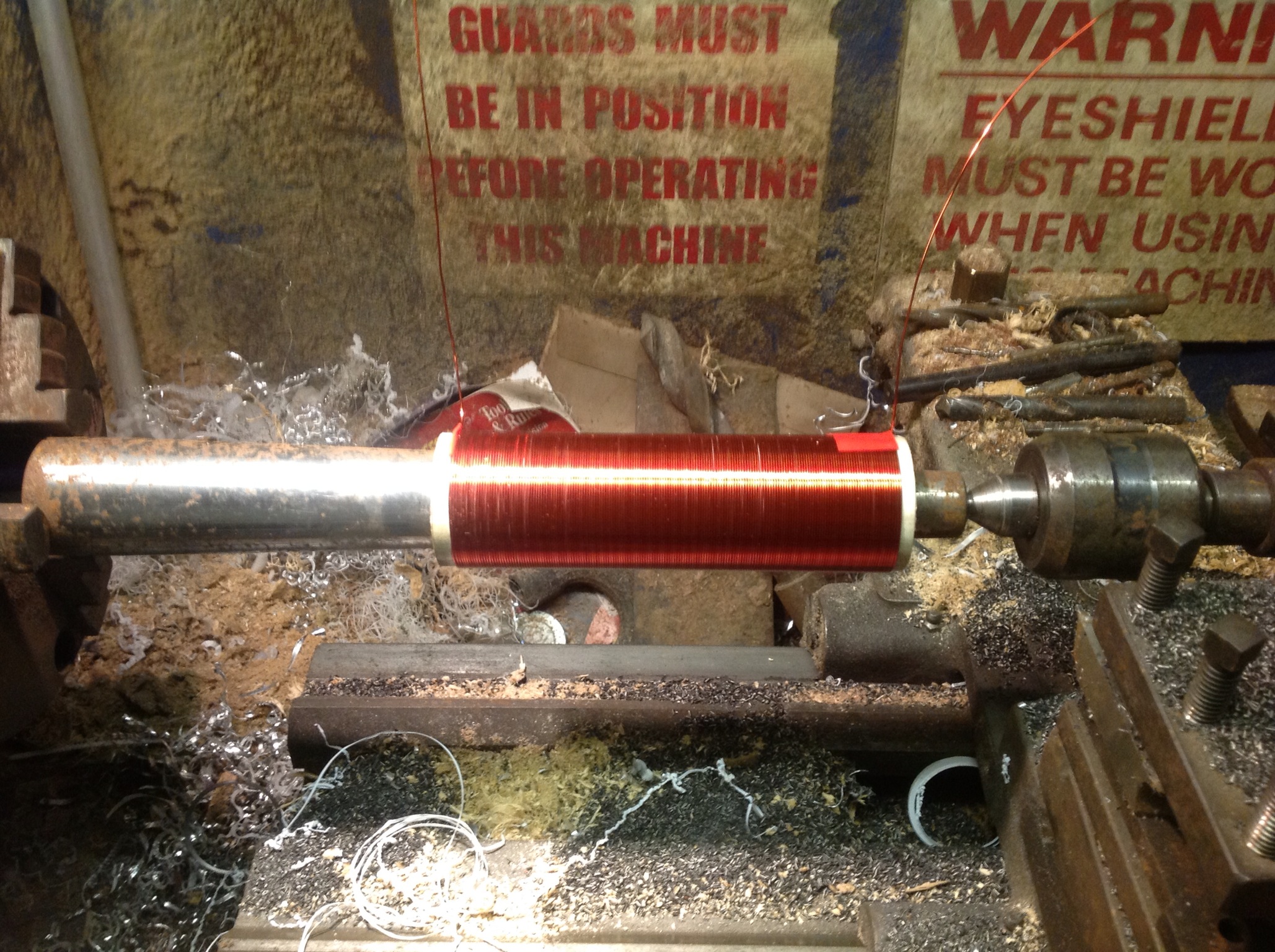

                  First of the parts arrived today, 10 shiny Ferrite rings.
                  Been out in the shed at minus 3 celcius winding the primary HV coil, nearly stuck to the lathe chuck!!!
                  Somehow my power transistors are in Liverpool, I live in N Wales, goodness knows what the postal system get's up to!!
                  I am going to use a complementory pair of TIP3055 and TIP 2095 to drive the Bias circuit, they should be able to handle the fairly high current I envisage being passed through the realatively low impeedance windings.
                  Will keep you posted.
                  • Mk 3 Replication. Initial progress/observation.
                    HV input is a little flyback transformer and beefed up power transistor from an old portable B/W television. It runs at a little over 16khz from memory.
                    First tests have been carried out with the primary coil in parallel with a 30 kv capacitor adjustable spark gap between them.(magnetic quench)
                    Secondary coil is 3 layer 1.5mm2 single insulated, 3 layers, 16 turns / layer. As per SR 103 schematic.
                    As per Mk2, a dull glow in a 40W 240 V incandessant light bulb is noted.
                    I replaced the mains bulb with a 12V 5 W fesstoon bulb. Quite a bright light is noted. But suggests insufficent turns for secondary voltage output.
                    I then tried changing the HV cap for a chain of 2Kv/cap capacitors and what a difference!! Blew out festoon bulb, warmer glow from 240 V bulb. Suggests dying HV cap (it wasn't cheap!!)
                    If anyone is interested, please ask, I will furnish full details of L and C, No of turns etc.
                    It is getting late now but once I had wound the primary coil I just couldn't wait to find out if it worked!!!

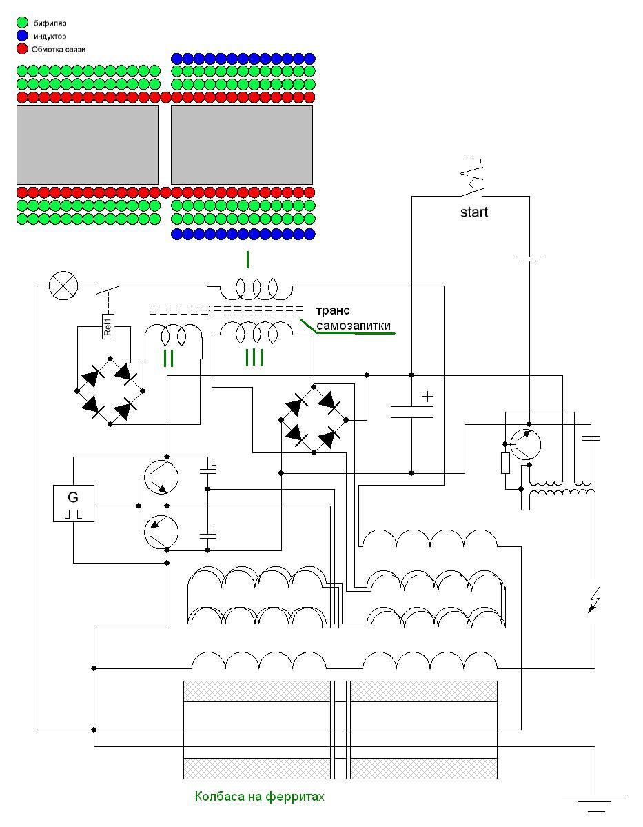

                      I feel that from all the schematics that are out there the one posted by Vidbid seems to embody all the aspects required.
                      The question,
                      I am about ready to wind the bias coils. We have studied and studied and feel that the pictorial representation is a two layer Bifilar. The only thing is are they wound in opposition to each other ? Is it the intention to concentrate the flux at the air gap between the Ferrite cores?
                      Any comments gratefully recieved.

                          currently I am trying to replicate the SR193 device, that in my opinion is a normal transformer with HV applied to the cores, which should do some amplification effect. It can transform a 50hz sine wave to the secondary; you will see huge HV spikes when the sparc gap is in action, but no amplification effect.
                          4im06192010.jpg is the schematic I used.
                          Both coils do not overlap (like fabrice andre's) and in the description of 4im06192010.jpg
                          For the ferrits the material 3C90 was used.
                          Help is needed by someone , who replicated successfully, evt. write a PM.
