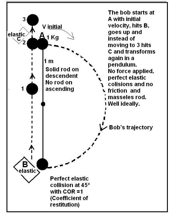

      • #18
        My intention is to model a hypothetical mechanism like the picture below.
        • #19
          [ATTACH]6134[/ATTACH]
          You have an interesting model there to evaluate.
          We know that the acceleration due to gravity will be consistent regardless of the starting velocity. However, we also know that the starting velocity reduces the overall time required to travel between the two reflectors.
          Here is a fun little app: Pendulum Physics Simulation
          And here is full treatise of the amplitude dependent formulations:
          Large Amplitude Period of a Physical Pedulum
          The problem you have posed is a bit more complicated than the norms because it presupposes a switched massless rod that becomes flexible (or none existent) at BDC and become rigid at TDC. Or to put it another way, we turn off centripetal force during the vertical reflection period and turn it on during the swing period.
          It is very tempting to just add our initial velocity to the result velocity using the equation I posted earlier:
          so that BDC Velocity = (initial velocity) + sqrt(2 * gravitational acceleration * length * [ 1-cos(angle)]
          (20 m/s) + (√ 2 * 9.8 m/s² * 50 * [ 1 - cos(180)]) = 64.27 m/s VBDC
          But I am not so sure this is the right way to do that since that equation is really an approximation. But it might be good enough for your evaluation
          For an accurate result, we would need to apply calculus and integrate force vectors along the arc path to arrive at the VBDC.
          To determine the final velocity at TDC (VTDC ) we simply need to apply the negative acceleration that results from gravity pulling against the vertical bounce. In this case it is consistent and straight forward just like dropping an object, only in reverse. You can think of it as deceleration.
          The expectation is that
          VTDC will = 20 m/s supposing that there are no losses in the system and the process would continue indefinitely. But using the straight motion calculator here and plugging in the 64.27 starting velocity for VBDC and -9.8m/s² we don't get 20 m/s, but instead get 46.59 m/s as our VTDC.
          So as tempting as it is to just add the velocities together . . . I think there is a problem with that. Otherwise your model would produce an OU of about 26.59 m/s on the first cycle and that would grow exponentially in time.
          Since that is not possible, I have obviously made an error somewhere. (probably in trying to add velocities, or applying angles greater than 90° to the equation or something like that)
          EDITED: For a 50m rod length and 100m overall height

          • #20

            • #21
              The error exists in the equation itself which supposes a definitive time embedded in the 'g'.
              In order to allow for a starting velocity, we must bring time back into the equation because the overall swing is driven and overrides the resonant period of the pendulum causing a shorter period and thus reducing the overall acceleration of gravity.
              Therefore, the equation:
              v = √{2gL[1-cos(a)]}
              needs to be rewritten to include time, or we need to find a formula for a driven oscillator rather than a harmonic oscillator that will give us the velocity of a rigid arm arc in a gravitational field with a starting velocity.
