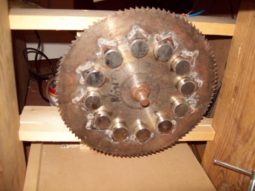

        get ya started
        here are the two main parts, 10inch saw blade(would suggest welding steel tube onto blade instead of angle L iron), 1in X 1/2in N42 magnets, spool: 2.15inch inner width, 1inch core diameter, weight: 15.14oz, 49ohms, wire: 0.015inch with coating (don't remmber 24 or 26 AWG) 1inch dia. standard(cheap) bolt that my dad cut the edges off of the head
        total cost: about $55
        magnets from: https://www.magnet4less.com think they have good prices
        this should get people started replicating
          My experience
          if i remmber correctly, I was only able to get out about 6-7 watts from this coil. I wrote thane and he told me to build another coil with 22AWG wire for higher output. I calculated the resistance/foot of his better coil, and I would need about 8 pounds, that is about $80 from my supplier which is a local electric motor repair shop. So I would suggest building one of his type if you are starting to replicate, learn from my design and save money.
          Important info! Please read.
          From what I have noticed, there is "NO" counter force made by taking electricity from the coil. There is however a counter force caused by the magnetic drag of the steel/iron core(large bolt in my case) this is proven because in my tests the motor does draw more current when the core is in front of the rotor with the coil "DISCONNECTED" than when it is not near the rotor at all. When the core is close and the coil is connected(producing usable electricity) the rotor does speed up(accelerate). So literally the drag of the core is reduced somehow by the field of the coil being connected. This effect increases with more energy being taken from the coil. In summary, if I make the larger coil(7-8lbs 22AWg 60ohms) which extracts more electricity, while using the same core(the only source of drag) it should reduce the core drag more and produce more output in watts.
          sorry for the lengthy explaination, it's a lot to comprehend.
          jake
