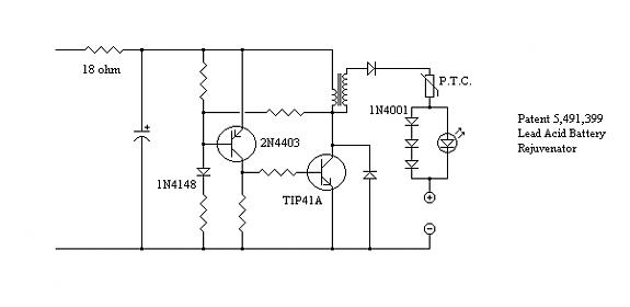

Connection Alternatives
Attached is a circuit diagram which is very
similar to the "Stingo" arrangement.
By studying the circuit connections it may
be possible to try varying certain component
locations in the circuit layout in order to
achieve optimum performance and stability.Attached Files
