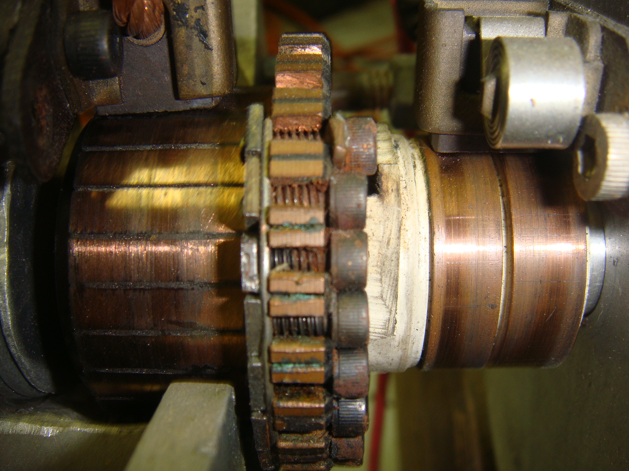

  • Finally get a chance to take some pics of a comm setup that is very easy to put together and very adjustable. Like I said just mount them both on a shaft and jumper as many comm segments together as needed then connect the slip ring terminal to the segments jumpered together. HTH Wayne

              • The commutator is almost complete, just lacking a spring system. I decided to take a few measurements on the frictional losses ( brushes, bearings, flywheel etc ) and found it to be quite high - much higher than I would consider good. Taking some measurements from the flywheel I ended up reading about 1.5 lbs on a 3.37 radius to start rotation. This would be a load of about .4 ft lbs continuous and at 3000 rpm were looking at mechanical losses of around 170 watts - not good.
                The motor alone runs 80 watts no load, with the flywheel it draws 110 watts until it's up to speed then falls to the original 80 watts but with the starter connected draws 180 watts. The starter motor may not be the best choice. Removing the brushes from the starter it seems to freewheel quite nicely, the brush drag is extreemly high.
                I'm going to look into some alternatives and start work on phase 2 of this project. I believe Peter's attraction motor to be a far better alternative to the starter motor.
