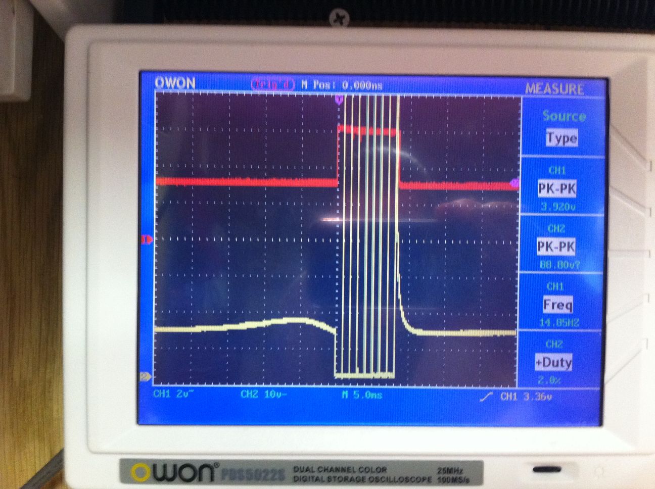

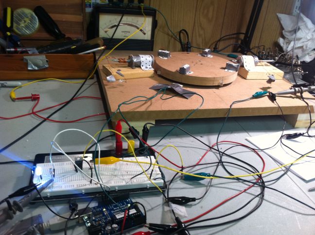

          • my updates: today I build my rotor with all 4 magnets (I don't know their gauss value but soon I will know) and 4 very small trigger magnets. Rotor is to spec of 200mm diameter.
            Switching hall-effect A1302 is in use and I am programming a Arduino Duemilanove. This baby is sooooo easy to program and it is very fast too. I can pulse at microseconds with very easy which I think it is already too fast for this application.
            I am able to switch from 1 to 20 times or more per top of the sine wave when magnet passes on coil. My coils are very small and under 10 ohms as I used them for an Adams motor project of 5 or more years ago.
            Voltage directed with a diode from the coil easily generates 250+ volts which charges a 10uf/250V cap in about a second or so.
            It is interesting how this motor behaves as one changes the position of the hall-effect and the numbers of pulses per pass. I have not being able at this stage to do anything fancy since I am only at the setup stage.

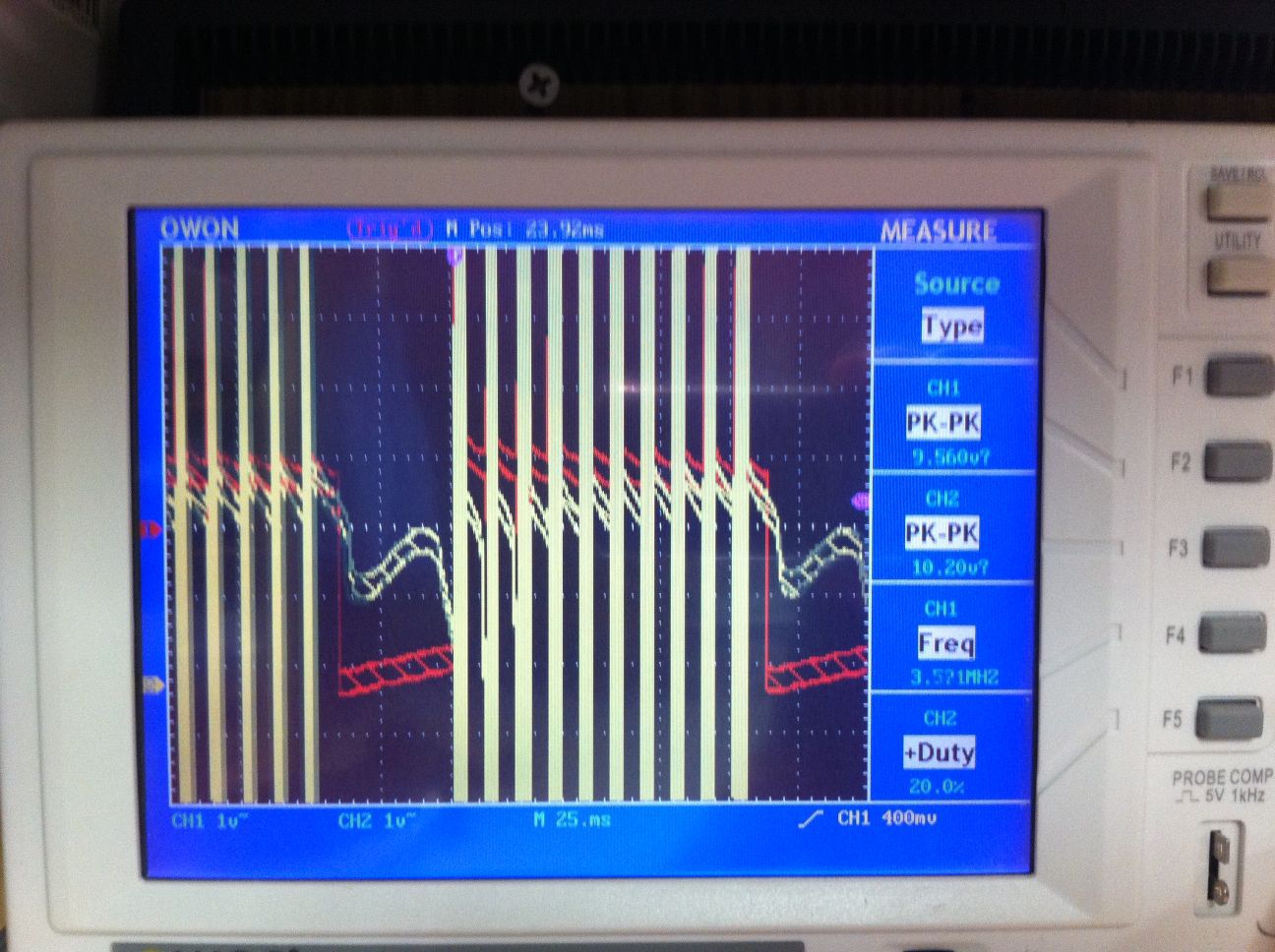

                      • I have been testing my Adams with one drive coil only and one generator coil. The generator coil has one LED connected so to create an small load.
                        The drive coil is being pulsed 5 times as shown on the picture of the scope. Battery voltage IS RISING as it runs. It is running at 20ma - 12v from a 85 amp/h lead acid battery.
                        I am redirecting the pulses BEMF from the drive coil back to the driving battery using a diode aka Bedini style. This is just a few test I am running.

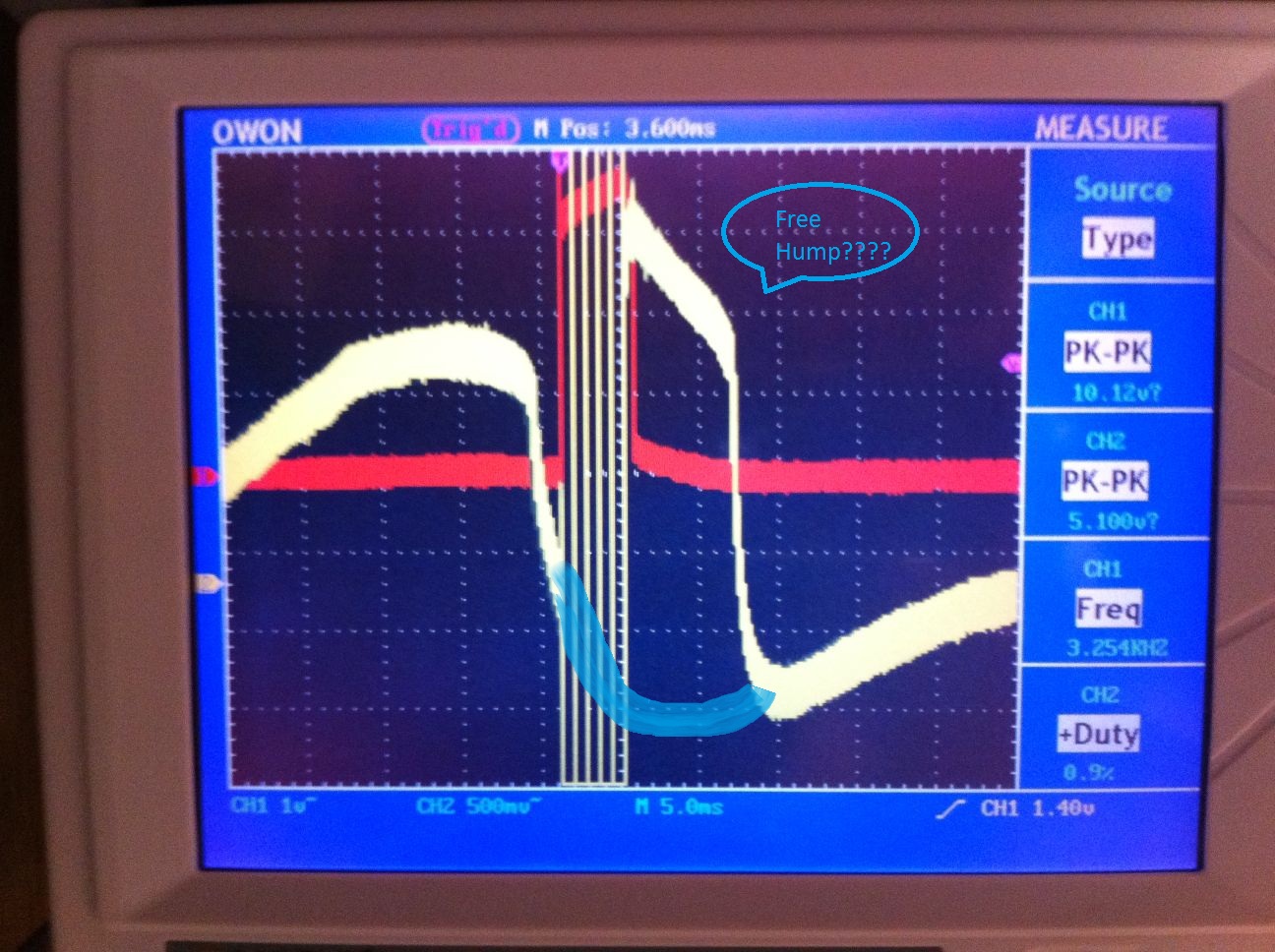

                        The interesting thing that I don't understand on that scope shot is the extra "hump" I see. In yellow is the induced voltage on the drive coil as the magnet passes by. One can see clearly 5 pulses being done as TDC BUT where the extra hump comes from. It only shows there when I direct the BEMF back to the battery. As Rod said: funny things start happening when one puts a load on it.
                        The blue manually painted line is where the induced voltage would go when not pulsing is done.
                        Fausto.
                        • This free hump IMHO is a standing wave that is created when the coil is switched off.Its frequency depends on the length of the wire.
                          There is another setup of a Spanish experimenter, consisting coils of high real resistance (not impedance!). (Both have together about 68 Ohms)
                          The duty cycle is 25% . He did not mention that the device does not heat up , but claims to have overunity (by the values published in his blog). So heat is less likely.
                          His circuit is really simple:
                          El Motor Adams
                          I have ordered the magnetic sheet allready.(I will rebuild his device)
                          And if anyone has build up the setup like him he/she should publish the facts observed. I think its a conversion of heat into force / hence electricity.
                          • I have been playing with my setup tonight and I think I found something VERY interesting.
                            I am able to make that "free hump" happen many times per magnet pass and improve things. More humps means more current consumption BUT it will also generate much more energy back.
                            See the picture below and you will notice that I am pulsating 10 times per cycle and 10 times per magnet pass. Each group of 10 pulses creates one "hump" and creates also a lot more energy back.
                            Fausto.
                            • Originally posted by plengo View Post
                              Fausto.
                              Great work. You have replicated the first stage of the motor generator.
                              You have all ready seen the first positive results of the multi pulse at work.
                              as you said you now get more current back. do you have that capacitor in circuit I refer to as C12?
                              there is a ideal amount of pulses per RPM = frequency. do you adjust the duty cycle in relation to the total PWM. have you been able to calculate the ratio of energy in verses energy out.
                              Tried something new today. I have had this idea I have been think about for a while now. I put the coils inside the rotor.
                              • todays experiment
                                I tried this today. I have been thinking about this as a new approach to an old problem. It worked OK. But I could not achieve the same efficiency.
                                the coils where placed inside the rotor. it ran hard but used to much energy
                                it sill had some of the cold current. but not enough.
