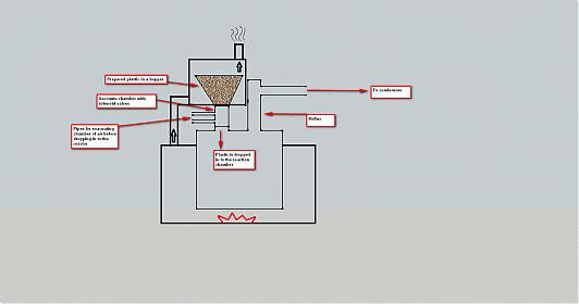

Thats what we tried yesterday.... minus the vacuum section... its in the picture on the last page.... it was rubbish... the plastic has built up around the feed pipe and created a blockage... my first job today is to cut it out...

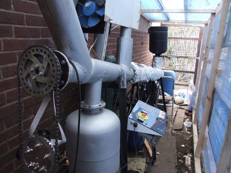

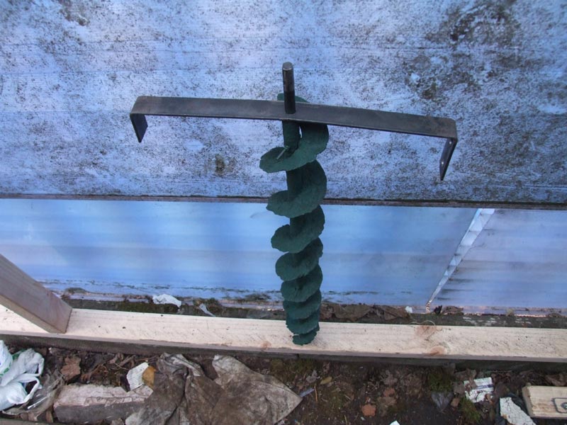

A quick redesign has resulted in the addition of an auger inside the hopper... the hopper has a lid... put plastic in hopper and attach a cordless drill to the auger... the gases only come out when you run out of plastic... at which point you remove the drill and close the hopper lid...
The pipe is also insulated now
Still no purge gases... This isnt theory... this is an actual running machine...
