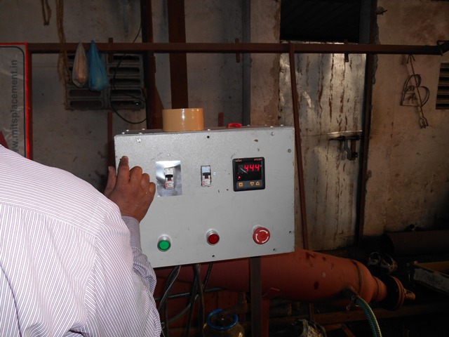

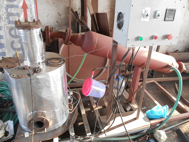

  • Thanks, ndsunil, for posting your report of a successful run in your pilot plant with various plastics. I agree with jonathan, larger photos would be more useful to see how your pilot plant works.

        thanks for photos. do you have fuel samples?
        • Thanks, ndsunil, for posting better photos. I like the flanged design of your retort, and the modular construction afforded by those flanges.
          However, the condenser looks like it might be too close to your reflux, as steel pipe, even though flanged, has a fairly high coefficient of thermal conductivity that there is probably a considerable loss of energy to the reflux from the water condenser, and the water condenser is probably not as efficient as it could be due to heat gain from your reflux. So, if you think it is a problem, then adding a 1 foot (300mm) extension to your vapor pipe between your reflux and your condenser would probably make the system more efficient.
