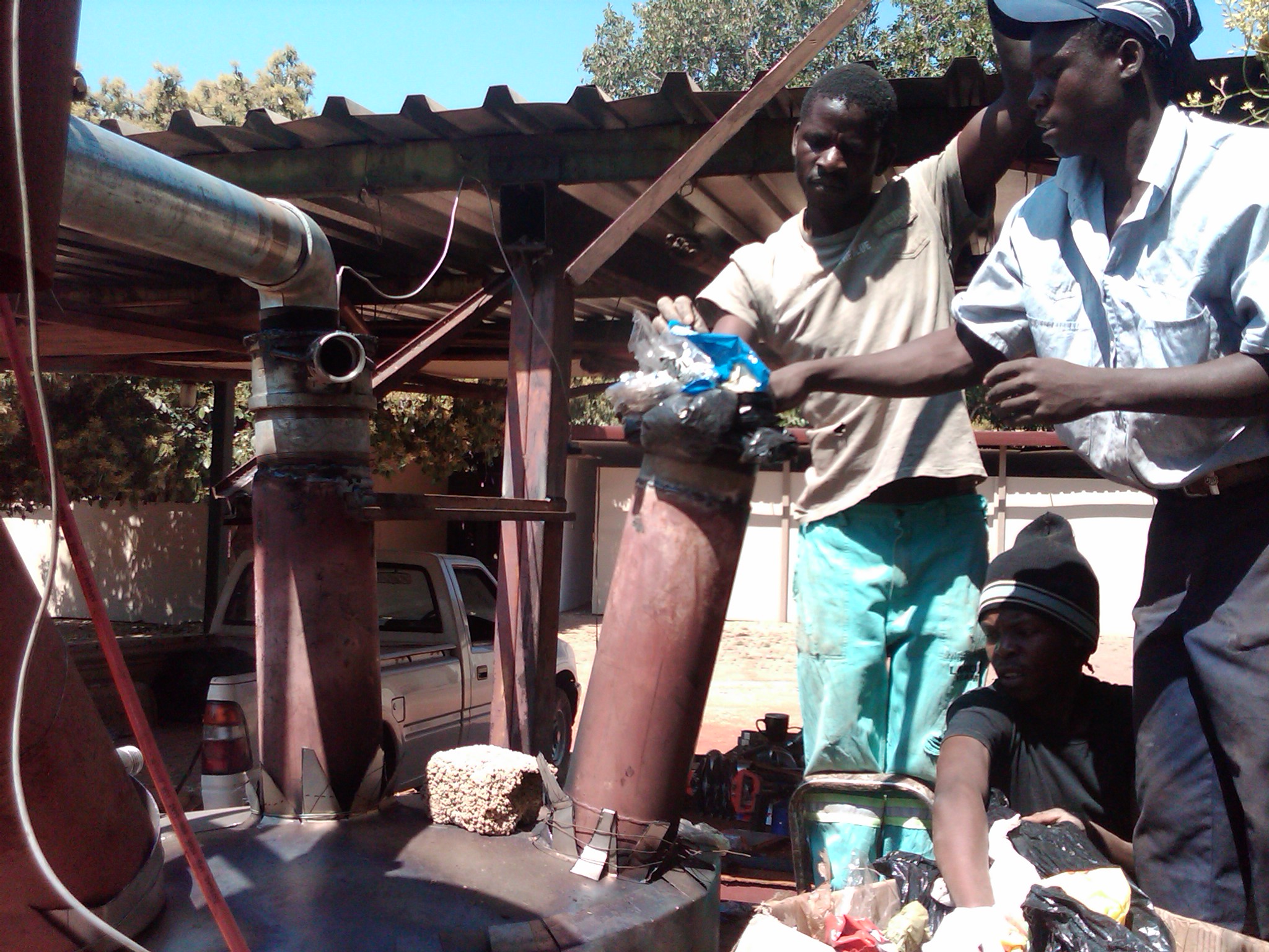

              Look at my picture. I am using a gas fired reactor with ash isolation. 3 openings on top. The centre one is the Reflux and the idea is that the heavy chains (the wax) fall back into the reactor. The blue drum on top with the chimney from the reactor and green heat shield is the catalyst with its own gas burner. I put any type of broken pottery, bricks, ceramic tiles ect. with lime powder inside and it work well.
              I have seperate and weigh my fuel. The bottom part is 950 gram per Liter and the top part 710 gram per Liter. That make it Diesel and Petrol !!!
              The 2 green pipes are my condensers with beer bottels inside and a water cooler between them. From there the remaining gas go back to the furnice. The white pipe with the fan give extra air to make the flame blue.

                        I don't know the plastic to fuel ratio because I reload on the run. (see picture)
                        Thanks for the drawing.
                        I prefer the reflux between the reactor and the catalyst. The heavy stuff must fall back into the reactor before entering the catalyst.

                          • I'm quickly finding that clean regrind plastic is fairly expensive in my area and am starting to lean toward raw plastic waste. Is there a contamination issue with labels and a little residual milk or orange juice from milk and orange juice jugs particularly in a continuous process system? I would think this contamination could be vented off at the lower temperatures of the beginning heating cycle of a batch system but I don't know how this could be done on a continuous system.
                            • Fire
                              That's what happen if you open the drain plug when its hot.
                              • The contamination is not as much of a problem as it might seem. In a batch system it is actually an advantage. The small amount of water will quickly boil and displace any air in the system. Paper,dirt, oil etc will either char in which case it stays in the reactor, or gasify and be burned off with the other uncondensed gas. Traces of water may end up in the final fuel. If this does not exceed 500ppm it is not a problem.
                                My chemist friend supplied with some bromine solution yesterday and I tried it out. I put about 2ml of bromine solution into a test tube and added a drop of my best fuel. The brown bromine and golden fuel instantly turned perfectly clear. This indicated that my fuel contains unsaturated hydrocarbons or alkenes. Unfortunately the test does not tell us how much of the fuel is unsaturated.
                                The reason this test is important is that unsaturated hydrocarbons are unstable and will tend to oxidize and polymerize more quickly than saturated hydrocarbons (alkanes)
