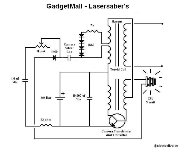

                            • Another modification of lasersabers Joule ringer . I dont think this is off topic very much as i dont know the exact specifications of the bifialer magic coil .
                              I do see a big advantage using another coil on top of the transformer though.And the Germaniums(leaky diodes) are a must . i tried caps and resistors and they work but the draw is mesurable with them . i dont see any noticable current draw on my meter using an arangment of germaniums and a coil. it less than a few micro amps . I believe becuase of the feedback or as i like to call it reguaging of the supply and transistor.Others may have different results as out of three aaa fugi transformers only two light a cfl . the other will light a neon but not the tube hooked up exactly the same .
                              this one attached is still running over 40 hours on one cell lighting a 9 watt cfl . the only difference on the one running is Jesus (the schematic artist) did for me from my cave man drawings shows 4 germaniums . i am using 5 .You can use as many as you like if you decide my mod to LS is worthy
                              I am just excited to see this run so long compared to a mod to a fuji did a few years back . Then it was amazing to get it to run 18 -24 hours . now its 40+ / wow . Plus i get extra power from the Hazens coil secondary and light an led also.Could be bridged for a cleaner output .
                              Caps should be in monday and then i'll concentrate on caps only . Right now it should run on caps but all i have is some leaky 2200uf and they dont work for more than a second.
                              As you can tell i have nothing but time on my hands . House work is done and my daughter is home and happy playing and observing . She got an electronics 150 projects and is quite good building circuits Wonder where she got that
                              Thanks for the alternatives cancer treatments everyone . thank you .
                              Albert
