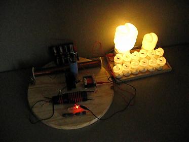

Joule Ringer!
  • Here my latest build. 50v 9700uf.
    E Core (ICH) 0P-45224-KIT:
    Ferrite: E Cores
    Transistor taken from:
    SALE! - 12VDC Tube Driver Board-The Electronic Goldmine

      • Originally posted by LaserSaber View Post
        Ferrite: E Cores
        Wow!! Looking good lasersaber - you never fail to raise an eyebrow!
        Obviously there will be a lot of questions, so let me start the ball rolling....
        How long do they stay at roughly that brightness?
        Whats your start-up battery?
        Could you get it working with any other CFL shape/power rating, or were these the only ones?
        Whats your setup?
        Take your time - i also have a wife and kids and job to juggle, so when you're ready!
            Ferrite: E Cores
            I'm speechless over here
            while I'm still trying to figure out heads or tails of why your original build works so well, you are already advancing light years ahead. you deffinately know what is going on w/ this ckt.
            look forward to any bits and pieces you are willing to share.

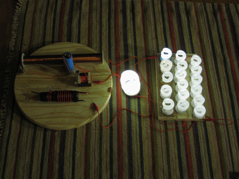

                  • Here is a quick update video showing my latest build running in a few different configurations. Sorry about how dark the video is, before I uploaded it to YouTube it looked much better.
                    Video link: YouTube - Joule Ringer with home made transformer.
                              This is the transformer most of us have been anxious to see !
                              In the meantime I was reading about saturation and reluctance and alot of
                              things alot of us would get discouraged by the complexity in transformer building so I want to congratulate you on the good work.
                              I can see that it is possible to get an E core wind it up and that the new transformer will not have the limitations with that of the small fuji transformer.
                              I have read that in simulation a zener diode acts as CFL but at much higher voltage if someone wanted to derive (back engineer) frequency and voltage for a particular CFL. However the Joule ringer is too exotic for standard simulators. The making and tuning is best follow lasersaber's methods.
                              Look forward to see more Joule Ringers and the progress. great job
