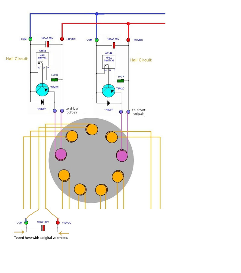

    I just finished the two driver boards. I powered the unit up to do a quick test. I have only tested voltage on one set of coils. With 12 volts in I get just over 16 volts out.

              • Originally posted by LaserSaber View Post
                How are you measuring the 16 volts? With a scope, meter, charging a cap.
                Can you please elaborate more on your coil, rotor and speed.
                Thanks, Mark

                  • Originally posted by Mark View Post
                    Thanks, Mark
                    Yes I have the same question?
                    how and where are you getting 16 volts from what?
                    please elaborate

                      • How are you measuring the 16 volts? With a scope, meter, charging a cap.
                        Here is a picture showing how I tested it. I do not know the rpm of the rotor. I posted build pictures over on overunity.com. It sure lights up a 12volt light bulb nicely!

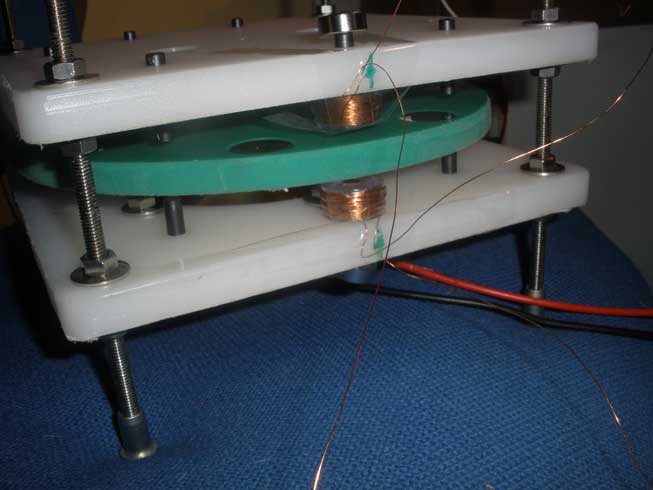

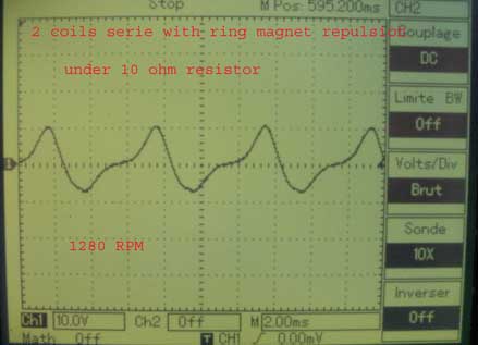

                        • Hi Mark
                          here some measurements i have made today on my set up of romero replication attempt.
                          so it seems to be possible to get around 2 watt per pair of generative coils. at 1280 RPM
                          My coils are sewing machine coils wounded with 0.3 mm plain copper wire.
                          I am waiting for litze wire to see if i can improve this result.
                          Good luck at all
                                Your picture shows the digital voltmeter and capacitor directly across the coil AC output. Am I correct in guessing that you used a bridge rectifier (not shown in your picture) between the coil and the capacitor?
