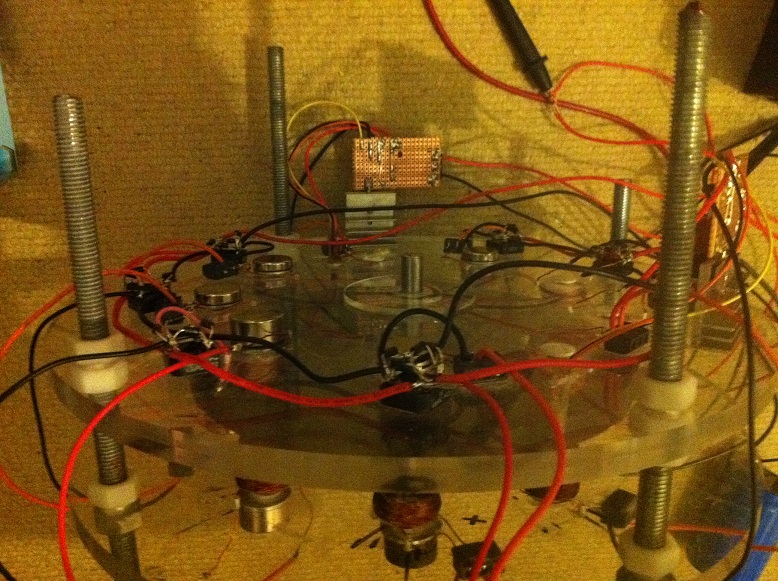

                        • Dont know where I got this pic from now. HAve been downloading every I found before its lost. just wanted to point out that the bottom plate does have magnets attached to the cores. The coil right up front with the FWBR up top does not appear to have a magnet but underneath coil has a large one. Over at OU they were trying to figure it out. In fact I think I got the photo from OU thread. Should re-post for them.
