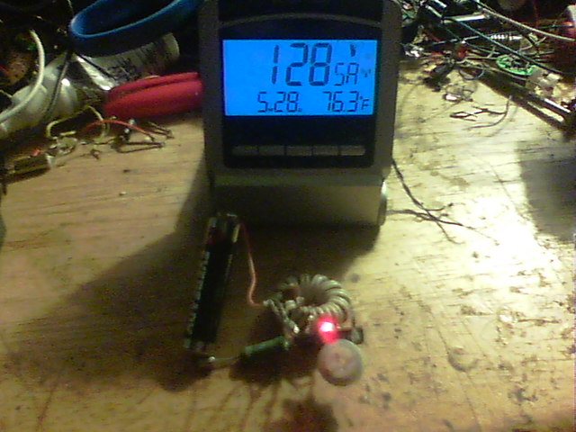

              Here's my pseudo replication..based on parts on the workbench, just to see if the circuit would work.
              I'm very familiar with Joule Thief's, but not in the configuration of this design.
              11 turn coil, with 10K pot, 2.2ohm resistor, 2K resistor, a 201 ceramic cap, red LED and C1213 NPN transistor.
              My battery is a 1.5V AAA, found in a door pocket of the car this afternoon
              My Sperry 6A meter reads 1.4V, as of 01:28 today.
              For this test, the pot is wound up to almost full, which hopefully means 9.8K.
              Inexact and done for a simple 'go' at the idea.
              I'm off to bed, will check if it's still running in the morning and, if so, see what voltage is left

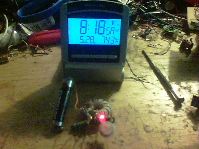

                  Here's my result of the overnight test..still going, at what appears to be the same luminosity and the battery is showing as just above 1.25V. Looks to be efficient enough to find the exact components and make another
