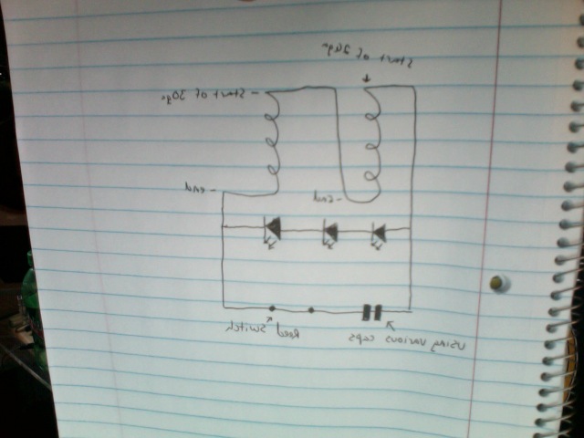

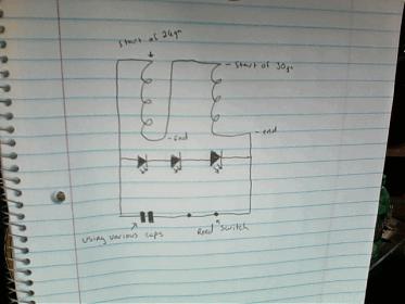

N8Can you give us a bit more detail on how your bifilar is wired? One wind is series connected with the other wind but which direction?
Thanks Zooty
This coil was one I wound up to run an SSG, so it's 150' of 30 gauge and 150' of 26 gauge. the way the coil is oriented as I am using it, the winds are CCW facing the rotor.
I hope the diagram I uploaded helps, it's one of the first I have drawn from scratch
I have marked the ends of each coil as start and end. not sure how well it came out in the photo after it was uploaded, so I just wanted to point out that is what I wrote in

edit: ok, I checked the diagram I uploaded and it is backwards for some reasonI used my comps built in camera, and it must have inverted the image...
I will just flip it and re-post, make life easier on everyoneAttached FilesThe absence of proof is not proof of absence
ok, here it is again...
hopefully it's readableAttached FilesThe absence of proof is not proof of absence
