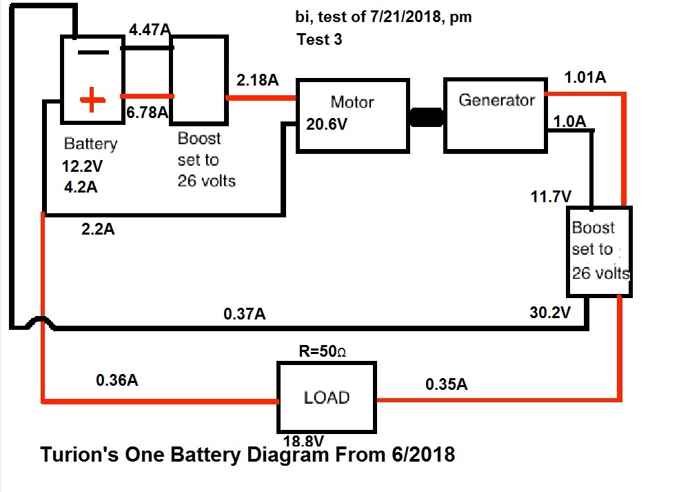

                        • Test 3
                          It doesn't look like you measured any return current. Really all you need to measure is the output from the battery to the first converter and the input from the return lines, first one at the motor output and the second at the generator load output. All hot side measurement, watt meters may not like that. They primarily are set to measure off of ground which in this case is not valid.
                          You wanna see whats being returned to the battery as well as whats being pulled out. The battery is going to drop the point is DID the load run longer this way or conventionally. IE Just wring the load up.
                          Here are all the current values and some voltages. Hope that helps. I attempted to tune close to the last test but didn't hit the mark exactly so don't mix data between tests. Configuration and components are the same.
                              The biggest problem is that first boost converter. Its not even running 25% efficient. If your not returning any power to the ground leg all you have is
                              switching costs running on the ground side. That might be 10% of what you'll see on the positive side.
                              Generally for 50 watt load I see 200-400 milliamp depending on the impedance in load.

                              • Converter efficiency
                                The biggest problem is that first boost converter. Its not even running 25% efficiemt.
                                The first boost converter is actually running surprisingly efficient. Efficiency is power out/power in, not current ratio or whatever you used to get 25%.
                                Output voltage on the first converter needed to be adjusted up to about 35V to get the system running smoothly. That number, 35.xx stares me in the face on the red led on top of the converter whenever it is running. For some reason I neglected to copy the exact value while collecting data last night. I probably have photo of it from test 2 on my phone. I'll check later. But for now, let's use 35V.
                                Converter input power = 12.2V * 6.78A = 82.7W.
                                Converter output power =35V * 2.18A = 76.3W.
                                Efficiency = 76.3W / 82.7W = 92.3%.
