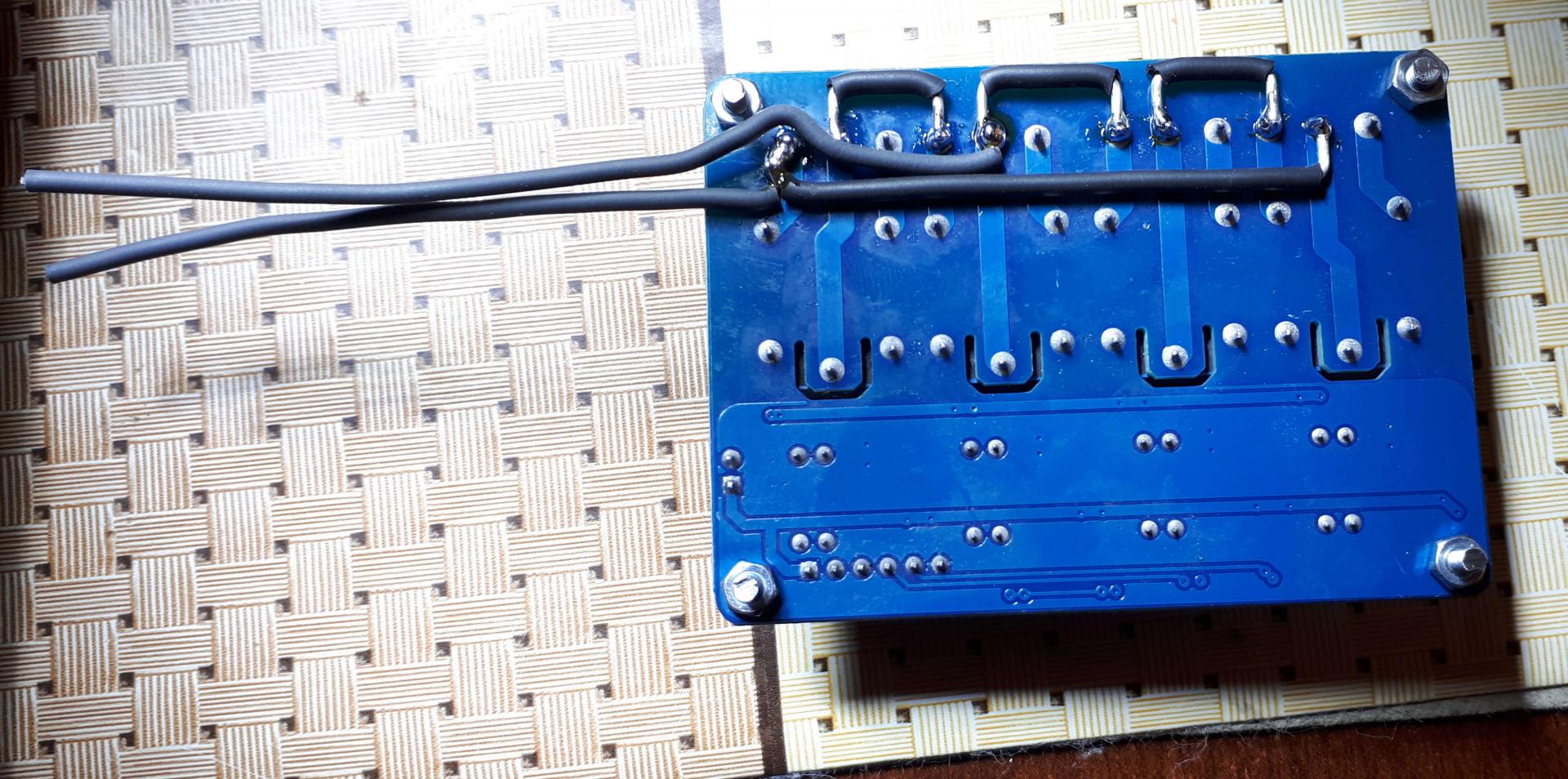

                            Just another quick update on my Battery swapper project, HERE
                            The wiring & all setup was simplified, a relay initialization bug was solved (all relays was ON at Arduino Boot for about 2 sec!), and a simple stopwatch is showing on the OLED display time passed, for comparing working cycles.
                            Now it's time to focus on conditional voltage loops...
