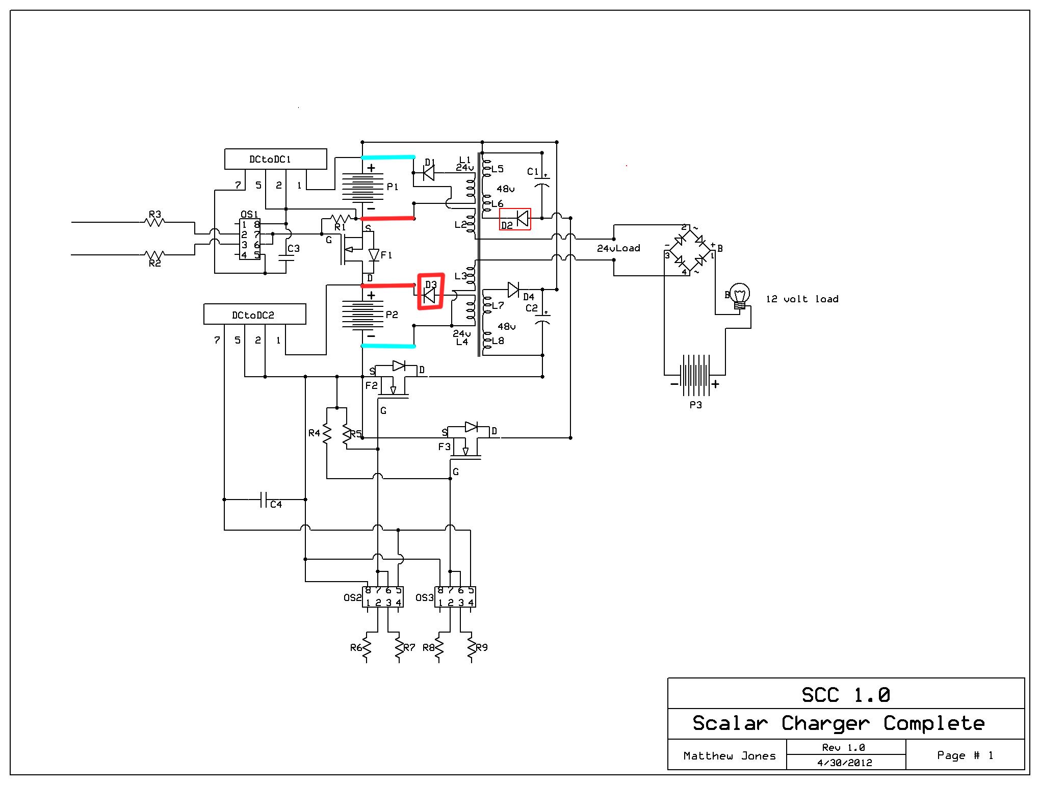

              • c1 d2
                Matthew
                Please help me here I do not understand how C1 can discharge through F3 when
                D2 is blocking it's + path to P1. Would it not work like this instead?

                  • Originally posted by rosehillworks View Post
                    Matthew
                    [ATTACH]11512[/ATTACH]
                    F3 discharges C1. D2 is in place to straighten the AC out. F2 Discharges C2.
                    Follow me?
                    Matt
