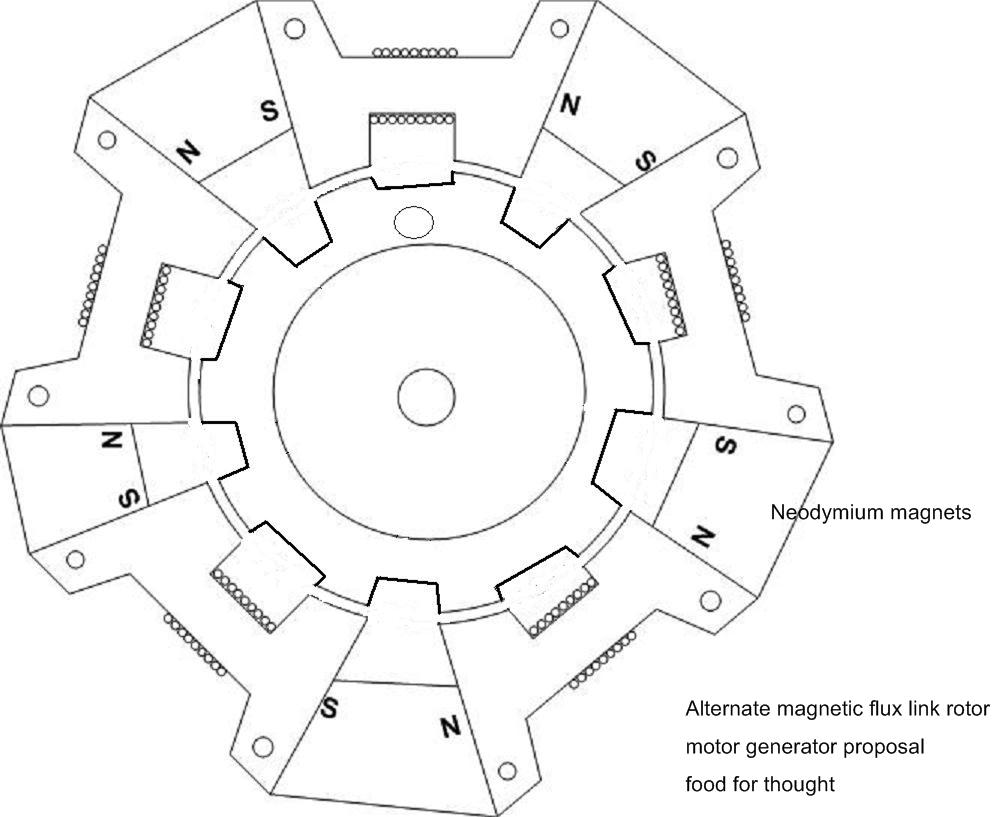

          Alternate mag-flux link rotor generator
          About the Radus double flux path design:
          There must be a way to mechanically switch the conduction path of the magnet from upper to lower rotor. This would be very interesting as it would take very little if ANY input energy. Any thoughts on mechanical switching for this device to eliminate coils?
          This already has great concepts involved in its design. It doubles the pulse rate, as each cycle of the radus style path is used, plus the expansive aspect of magnetism. I have never seen a device like this, I really like the possibilities here.
          This has a pretty good chance of working well, in my opinion, what do people think about making a cumulative build on this guy? You there Dragon? lol, I know you are a machining god.
          @ Armagdn3
          @ dragon
          I think there is a way to electrically control the path of the magnetic flux through the rotor and utilize alternative path and parametric control of the motor regenerator by solid state switching.
          http://www.energeticforum.com/attach...1&d=1332465991
          Hope it helps
          JJ
          • #65
            Originally posted by myenergetic View Post
            @ Armagdn3
            @ dragon
            Hope it helps
            JJ
            Thank you! Someone is paying attention!
            John B...Any thoughts?
            The switching can be done in a variety of ways. If you consider "Hopkinson's law: the magnetic analogy to Ohm's law" and the fact that all flux will take the path of least resistance you can imagine a few switching methods.
            If you have two paths for the flux to travel coming out of a magnetic source (permanent magnet) the flux will tend to the path of least resistance. If you the two paths alternate in their effective "resistance" or magnetic reluctance, the flux path will switch along with it.
            Reluctance can be changed by saturation of the core (or part of the core) along axial lines of the pm flux, or orthogonal to it (this could take the form of parametrics),
            which will also change permeability. You can also change gap spacing, or by moving something (ferromagnetic material, or another permanent magnet) in relation to to the Bloch wall.
            It is relatively obvious in my book why the MEG does not work as described. If you really wanted to make that guy run, I would ditch the trigger coils which create their flux paths along the same path as the magnet, and go for ones orthogonal to it. This will change the permeability of a section of the core increasing the reluctance of the loop associated with it. The result is still a change in the flux path, but now the output coils are not inductively connected to the trigger (which can be mechanical like in Wesley gary's motor, or electric).
