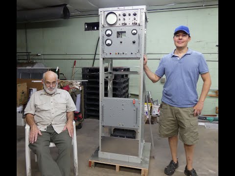

    • SPECIAL COSMIC INDUCTION GENERATOR PROJECT ENGINEERED BY ERIC DOLLARD - NEW VIDEO
      Check out this project that I've been working on with Eric Dollard non-stop for the last few weeks. https://emediapress.com/2020/09/09/cosmic-induction-generator-2020/

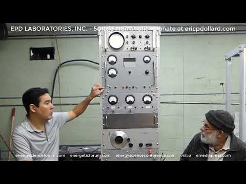

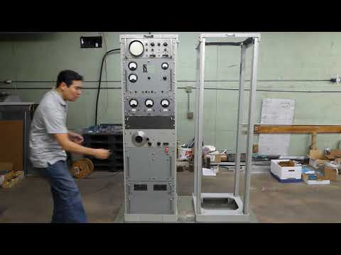

                  • NEW FREE VIDEO WALK THROUGH OF THE COSMIC INDUCTION GENERATOR - PART 2 AVAILABLE NOW
                    We already sent you a link to the video about the Cosmic Induction Generator that we're working on, which is more like a Universal Tesla experimentation system because it is very versatile and can do a lot of different things. That was explained in the first walk through video.
                    In this new video, we show you how far we've come in a relatively short period of time - on this website, there is both Part 1 and Part 2 videos and if you didn't watch the first one yet, I'd recommend watching both in order or you will miss out on a lot of information. You'll see in both videos that Eric is truly a genius engineer who cooked this all out of his head based on what I told him I wanted and it all came together perfectly. We're 90% done with the first rack but take a look: https://emediapress.com/2020/09/09/c...enerator-2020/

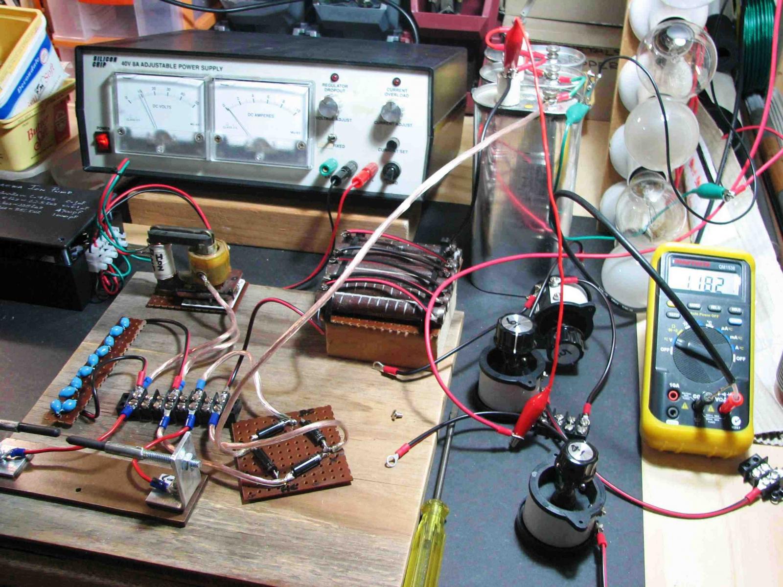

                          • Hello Aaron, Eric, Adrian, Ernst
                            Excellent work with the Linear Amplifier from the 2nd Video and have one question for you.
                            The EHT supply pcb is being driven from what source - 110vAC 60 hz?
                            The reason I question this is because what is being used in ceramics will not give you the voltage you expect.
                            My Resonant Negative Ion Generator (RNIG) was built using ceramics from AC 240v 50 hz and only gave about 950 volts when it should have been 5 Kv.
                            Those in the music game are using this same type of arrangement to power their EHT panel speakers but they do not realise that they are not receiving the voltage they expect due to a too low cycle hz,
                            The only solution to this problem is to go to an electrolytic which is really only a much higher value but adds the capacity component required and gives the result you are building for - I used 4.7uF 400v.
                            Individuals enter the high voltage scene but fail to prove their endeavours with a suitable EHT probe meter.
