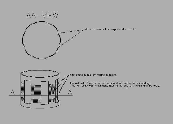

            Hi, I'm starting to get into the CRI. What do you think about using a drum shell as primary and secondary coil structure?
            drum shell available size: 8,10,13,14,16,18,20,22 inches. With a 14/16 inches drum shell you are in the 2000 kc/sec neighbourhood.
            https://pbs.twimg.com/media/CFJ290oWYAI2D6B.jpg
            I though about using these shells and first make spirals wire seats to achieve maximun symetry and equal wire gaps. After that i could do some material removal to expose the wires to the air. See inserted image. Maybe its not worth it to get coil symetry and gap perfect?

              That's potentially a good idea, but also possibly more effort than building from scratch and using wooden dowels when it comes to removing the material (accurately). I suppose it depends on what tools you have and your woodworking experience/skills. Also the downside is you can't choose the exact frequency.

                Thank you dR-Green for the reply. I`m trying to get some equipment; will build those coils.. (not sure of the building method yet) and then i`ll post my progress with a LOT of questions. Being a beginner with no contaminated preconceptions makes me a good match for the CRI.. but I see slow progress in my project after looking at your work and others. I`m aware of the frequency issue for the CRI.. but my ultimate goal would be the TMT. I`ll do my best to get a single structured coil for now.
                cheers!!
