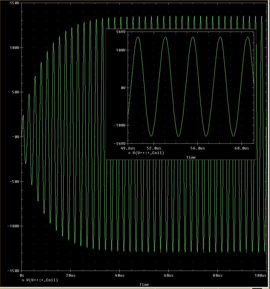

Voltage across a coil being pulsed at its resonant frequency. Frequency = 400kHz. Period = 2.5us. Pulse width = 0.6us. Supply = 150VDC. L = 50uH. Rinductor = 10 Ohm:
What is stated in the manual makes perfect sense. Please explain your point and what thunder?
