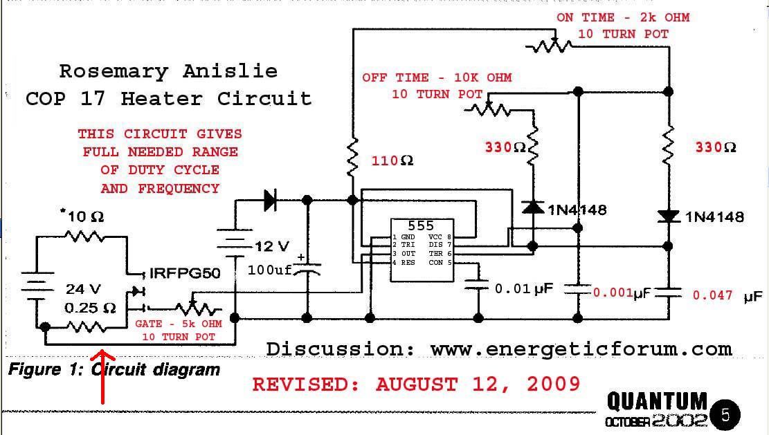

                • Why not just test resistive heating element in series with small choke to match parameters or orginal heating element ? Of course that's not the same as original element ,but a lot simpler.There is small probability it will work the same
                  witsend
                  Can you confirm the circuit which Aaron is/was using ? Is that the same as in your experiments ?
                  Pay attention to the wire connecting both batteries. Is that really what was in original circuit ? Would the circuit work WITHOUT that connection ?
                  Please, could somebody test it and comment ?
                  • Boguslaw,
                    What is the issue with the ground connection? I see none.
                    What I do see as a faux pas is Aaron's deletion of the 555 shunt and connecting all it's circuitry common to the MOSFET Source
                    But hey, Aaron's been working hard to defy good design and build practices from the very beginning, why stop now? On top of that he's got a bloke advising him to freely place all his probe grounds wherever he wants. Good thing "common sense" stepped in and saved the scope from a potential catastrophe (pun intended).

                    • Originally posted by poynt99 View Post
                      Boguslaw,
                      .99
                        witsend
                        Hi boguslaw,
                        You can view the schematic here on page two:
                        Quantum Article
                        And more information here on page 4 & 5:
                        Electric Heater Experiment - Aka 'White Paper'
                        You'll notice that there are really 3 batteries. Two in series for the 24V and a single separate battery for the timer. I have to admit, for my tests I did not provide a separate battery for the timer circuit - instead, I tapped the timer off the intermediate junction between the two series batteries. All of the 'grounds' were shared and bonded to an 8' copper rod in the ground via the scope probe references and scope chassis ground. A separate path to earth was strictly avoided to prevent ground loop currents. Therefore, in my case the circuit itself was 'free floating', only being tied to Earth via the scope chassis. There was no noticeable difference between having two references connect or just one, even though if a potential did exist it could have looped through those parallel circuits. The Ainslie circuit in the white paper clearly shows a zero reference being tied to the circuit, and that same reference is schematically shown as the scope chassis. How this was accomplished physically, I do not know specifically. Since the unit was operated at more than one location, it is reasonable to conclude that the zero reference was probably tied to the scope chassis or electrical earth ground by some wire. How much and by what wire gauge, we would need to ask Rosemary.
                        • Originally posted by Harvey View Post
                          .99, that is twice now you have made rude Jibes at Aaron regarding his choice for the current sensing resistor location.
                          Please explain for the readers the difference between his current sensing resistor and a galvanometer in its place as per your strenuous and repeated prior requests.
                          I see none. The resistance is of such a minuscule value by comparison to the rest of the circuit it is doubtful it will have any effect at all apart from raising the voltage at the source perhaps a volt and a half at maximum continuous amperage (which cannot possibly happen with the normal operation of this circuit). It is not uncommon for ammeters to have shunt resistors with these values (and yes, I am using the term shunt correctly in this case).
                          Once again you've missed the boat completely my friend. I was not referring to replacement of a shunt with an ammeter, my cause for concern was the complete deletion of the 555 shunt in lieu of attaching all it's commons to the MOSFET Source! This is per Aaron's own post #2627. The diagram dated 2009-AUG-26 is as I believe it should be with two separate shunts, but in his last edit in that post he clearly states that he is not using two shunts...get it? He has combined BOTH commons to the single Load shunt. Now unless I mis-interpreted what he said, that's just wrong. It's quite clear:
                          EDIT - actually, I'm not using 2 separate "shunts" for power measurements.
                          I have neg of 555 connected to source side of that "shunt" so I can see
                          power draw of both at same time.
                          Anyway, do what you guys want, just pay a little closer attention to what's been written ok?
