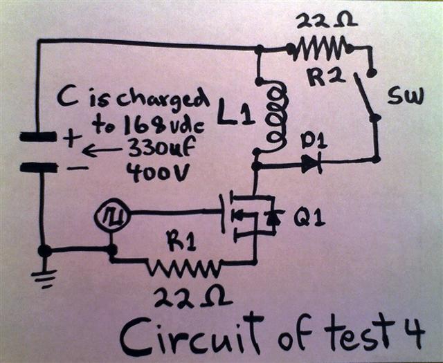

      So basically you want one 22 Ohm on the input side, right?... does it matter if it is on the + or the - side?
      the other 22 Ohm you want on the flyback side, right? so basically it is exactly as my circuit (see attached)
      and you don't want a heat reading of the resistors, just the mosfet and coil, right?
      At what voltage do you want this test done at and at what % of duty cycle?

      • Gotoluc - I'm giggling. I think we need all the heat measurements again. Hoppy made the calculation that there's a certain amount of energy over on your circuit. So. We need those numbers again - but including some ballpark on the inductor and the MOSFET. If you're game I am dying to see that video. It's actually quite important.
        Sorry to impose.
        EDIT - by the way - also on that circuit. Spot on.
            Sorry to impose.
            Luc
            Please also run the test with an identical lamp at the input and output.
