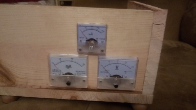

Yay, I finally got my parts in!!! I am in the building phase now... So far this is all I have, but Im going to need more magnet wire! lol, this first coil I've ever built and it may not have enough windings on it.
Measuring the ohms on this coil I get the following readings...
1.6 ohm on my 20 gauge Start Run (big wire) and
4.0 ohms on my 24 gauge Trigger (small wire).
I used steel, re-bar tie wire for the core material (from the concrete section at the hardware store)... And I used a standard terminal strip for the connections...
The rotor is a simple backside drive pulley for a lawn mower... I cleaned out all the grease with carburetor cleaner, and used my air compressor to blow it all out real good. I then used a few drops of oil made for my electric razor to lubricate the bearings just a little. It spins very easily!!!
I super-glued 4 neodymium magnets, spaced evenly apart onto the pulley, and then wrapped electrical tape around it very tightly... Hopefully the magnets will not fly off! I think I got them on there pretty good though.
Here's the pics of what I have so far...
All constructive comments are welcome... please keep in mind that this is my very first time, and Im bound to make mistakes
