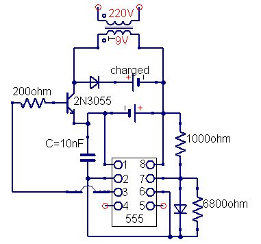

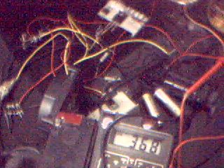

Thanks for the update. I'm running test on 12V 20Ah bike battery. She was sitting @ 12.30, right now has 12.98. Oscillator frequency 190Hz. Cap dumping @ 14.15V. Still wondering about frequency/cap dump. I was thinking about trying this on the wheel with strong N poles. I have a rotor with 16 poles from other setup
