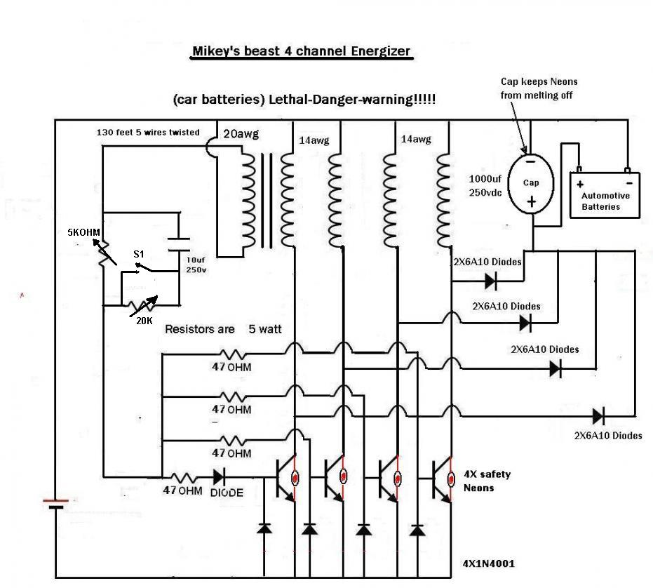

          • Sg Oscillator 26awg wire
            Hello friends and group members
            Here is an update on my web flyer that shows my beginners build of a solid state version of John bedini SG OSCILLATOR.
            BroMikey's Science Projects
            My approach is to bring the building process down to a level beginners can understand in a step by step build.
            These coils are the main way Bedini winds and twists. Then there is the basic very simple diagram with a hand full of electronic parts that even a young child can arrange on a bread board.
            My circuit is a step up from what the little girl built using a single channel.
            The little girl who built one for her science fair project back 40 years ago got such attention that these circuit are named "Sg" or "School Girl" Oscillators.
            Now people just see "Sg Oscillator" or "Simplified School Girl" "SSG" Oscillator.
            Her is me winding a coil. Well only partly shown in pictures and the other portion in text form.
            I energize batteries with this circuit but also use the pulse dc that is a form of AC for experiments. I like this AC signal because if you are experimenting and make any mistakes it doesn't blow the fusebox out of the wall on your house.
            I can get 100volts and not have to worry about melting transformers, if I goof nothing happens, it just shorts out with not damage to the circuit or any parts.
            This circuit is an experimenters dream circuit.

                        Here is what I use
                        I can charge batteries that are alot bigger if I hook up my cap dump.

                        • Mikey
                          Is S1 just a switch to turn it on and off?
                          Thank you
                          sawt2
                          Hello wrtner
                          There are video's all over youtube that show guys with the wheel Monopole motor that they learned from John Bedini that got up one morning and forgot to start the wheel and the batteries charge right up.
                          There is a buzzing of OSCILLATION. Look on the circuit I uploaded at the trigger wire hook up. This is in the patent and also around the web a couple of guys are circulating a diagram of the same thing. well you don't have to do it that way either. It works both ways without magnets.
                          That is John Bedini's patent and shows the SG OSCILLATOR circuit without a wheel. John has both patents of the same idea.
                          It is known as the SOLID STATE version of the SG OSCILLATOR.
                          Here is what I use
                          [ATTACH]14179[/ATTACH]
                          The wheel can do things that the SG OSC circuit can not do like put a generator coil on it to get a little more power back from the spinning wheel.
                          Attraction Mode, Repulsion Mode, FORCED OSCILLATOR MODE. The solid state version is known as FORCED TRIGGERING MODE. No Magnets and can run higher frequencies.
                          Each unit has it's place depending on the use.
                          Someone has a Ferris wheel 4 sale right now all made.
                          Mike
                          • Switch
                            Originally posted by Sawt2 View Post
                            Mikey
                            Thank you
                            sawt2
                            No it is to turn on and off an optional resistor to experiment with is all. You only need so many but I use more when i dial down to lower amp draws on the input.
                            That way I don't pop my smaller batteries.
                            mike
