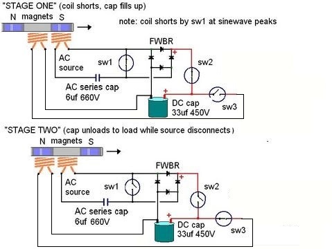

                    • Hi All,
                      You guys should seriously have a look at this -
                      https://sites.google.com/site/altern...coils-circuits
                      Harti posted at OU -
                      FUELLESS CAR PROTOTYPE by ISMAEL MOTOR
                      Regards, Penno

                              • no need for P channel FET
                                Hi John,
                                Sorry for chiming in but in these schematics no P-channel MOSFETs are needed, both FETs can be N-channel. Their sources are tied together and so are the gates, the drains are open like a normally open switch and when the control voltage appears between the common gate and source points there will be an almost short circuit between the drains: the switch gets closed and will be able to conduct current in both directions. (the body diodes are shorted by the 'on' channel resistances). This is the link I mean, first Figure:
                                IRF640 types are shown but any type with high current and 200-300V breakdown voltage data works. Both the breakdown voltages and the ON-channel resistances add up, input gate-source capacitances are paralleled.
                                Here is a better type I suggested to Doug Konzen on his EVGRAY forum:
                                http://www.irf.com/product-info/data...rfs4229pbf.pdf
                                It is a 250V, 45A device, its ON resistance is .042 Ohm @ 10V
                                gate-source voltage, PD 330W.
                                Another type is:
                                http://www.alliedelec.com/Images/Pro...R/925-0001.PDF
                                It is available here Fuji Semiconductor - 2SK3554-01 - Discrete MOSFETs - Semiconductors - Allied Electronics
                                Could you share that when we short a coil with a switch like this (or any other switch suitable for the task) how much the shorting effect reflects back to the energy source that caused the induction in the coil? I have not yet tried coil shorting in practice (I want to do it) but would like to understand why there is no or only a very little input power increase when doing the coil shorting. Doug Konzen shows the scope shot on his shorting the coil at the peaks of the induced voltage in his above site.
                                Thanks, Gyula
