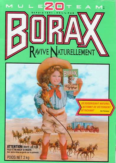

          • John, are you using the basic borax soap purchased at grocery stores?

              • Earth Lights
                Dragon,
                Yes Borax is a store bought product, unless you want to find a Borax mine somewhere.
                John B

                • Borax
                  V

                  • Originally posted by John_Bedini View Post
                    Dragon,
                    John B
                    Thanks John, I wasn't sure because there are quite a few web sites selling it as crystals or already in solution form. Since it's going by many names I want to make sure I picked up the stuff you and everyone else has been using.
