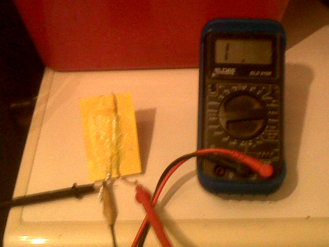

      • behavior of my glue battery
        hi i can read the resistance only if I connect the positive terminal of the tester to the negative pole of the cell and i read a negative value,the meter is in 20 mega ohm range
        ingredient: salt substitute, magnesium sulfate, vynil glue,aluminium and copper electrodes
        is normal?
        sorry for my bad english i'm italian
        ciao luca

          Dear Luca,
          I have seen negative resistance values with my ZnO
          Material with two magnesium electrodes.
          Very best regards,
          Jim
