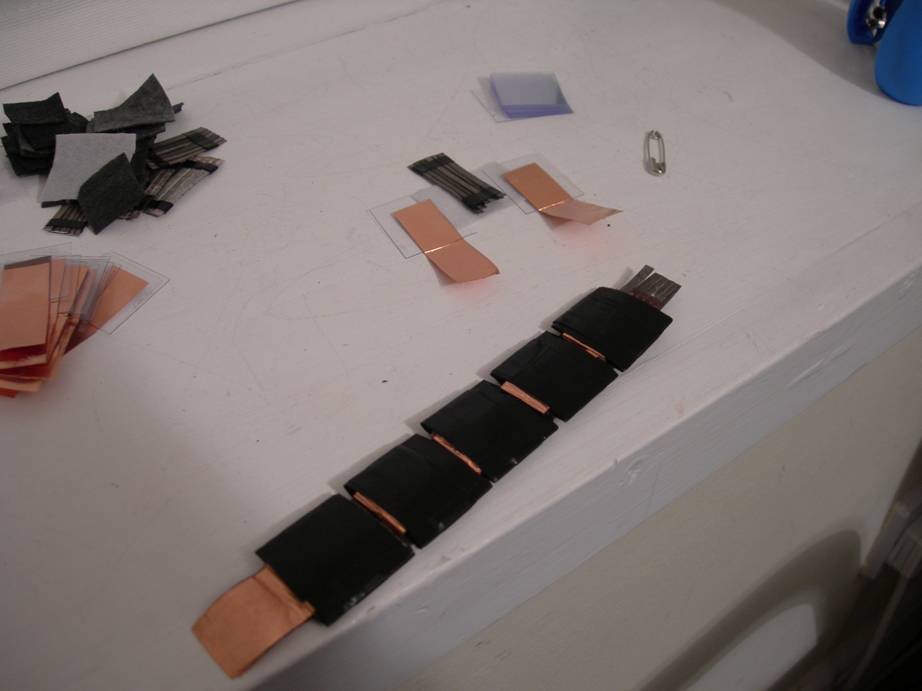

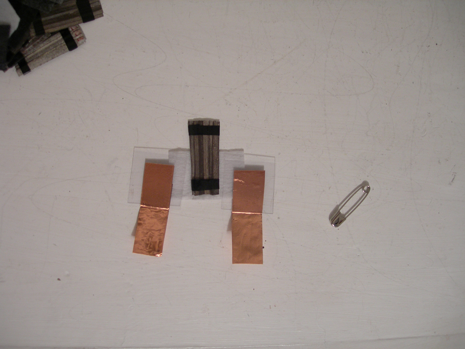

              • Stress Induced Amplification
                Hello,
                I have been experimenting with some flat cells and can confirm IB's discovery. I found the effect when connecting one of my cells in-series to a 9V battery and an ultra-bright LED. BTW, The flat cell's high ESR allows the 9V to run the LED brightly without shorting. The cells are made from plastic slipcover sheets (for microscope slides stapled together) and bound by electric tape (images forth coming). When I applied sustained pressure (squeezing) the cell in a darkened room I could seen an intensity in brightness from the LED. The question now is how long will this boost be maintained. I have a little portable desk vice and will run your replication tonight.
                BTW, the cells are made of copper foil and oxidized magnesium ribbons as electrodes. Both electrodes were lightly brushed with silicone adhesive and I added what I call a p-type salt mix to the copper electrode and a n-type salt mix to the magnesium electrodes. I simply sprinkled the mix on the silicone-coated electrodes and patted them in with my fingers. I then wrapped a thin-craft cloth (that is dry but previously super-saturated with Epsom and Salt Substitute) around the magnesium electrode (and coated the lot with a liberal amount of PVA glue) and made a sandwich between the two plastic slip covers. One of these puts out about 1.3-1.45V average and two in-series will light an LED moderately (depending on how many magnesium ribbons I strap together to make an electrode, increasing surface area). Although, prolonged running the LED will dim to a minimal brightness after about 8 hrs.(as expected), I think the power of all of these cells though will be in connecting them in vast arrays either in series or in parallel and exposing them to high pressure in a mechanical vice casing of some kind.
                IB, in your test the uA of you cell increased by 100 fold. Imagine if you had a flat version of this cell and arranged them in arrays 2-D then stacked these arrays on top of one another.
                Here are the ingredients for the p-type and n-type:
                p-type:
                copper oxide powder
                pulverized (Epsom, salt substitute, activated charcoal, Iron Oxides red and black)
                n-type:
                zinc oxide powder
                Anyway, IB excellent work, some pics of my cells will be attached soon. Now back to some more cell making I want to get to a 40V stack by New Years
                -Artisan

                  • Replicate flat cell
                    Sure. Please do. BTW, I edited my last entry. I failed to mention to brush the cloth-covering the magnesium with some PVA glue.
                    Artisan

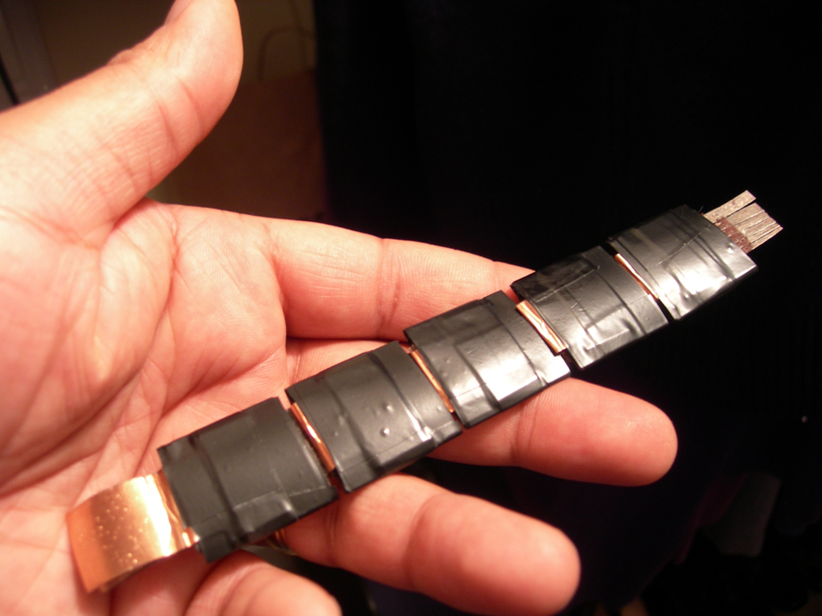

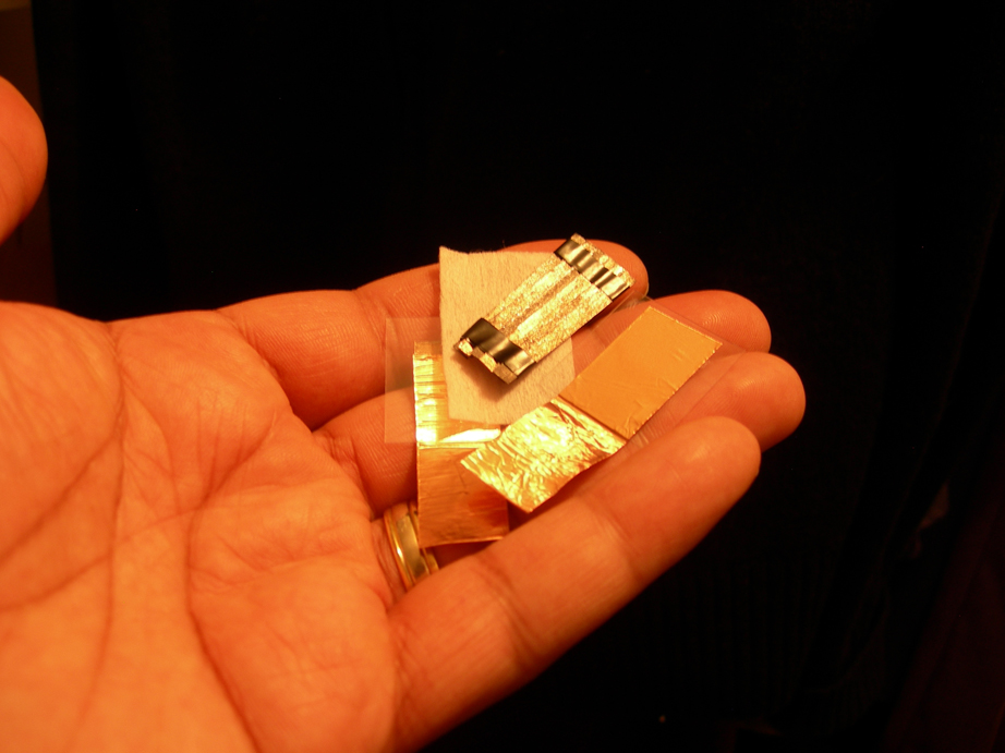

                      • Follow-on: Stress Induced Amplification
                        Here are some images as promised. Once you have everything in place it takes about 3-5 minutes per cell. Most of the time will be spent in the preparation.
                        Artisan
