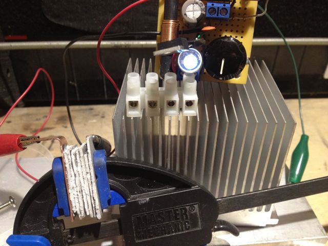

              • Its a new morning and the Sodium silicate & Epsom salt cell that I made yesterday is dried out and is hard. But the cell is now resting at a steady 1.557 volts @ 60uA. This when first made was giving over 1.600 volts @ over 5mA, but as it dried out its now resting at a lower amp but the volts almost stayed the same. For a dry cell I would consider this a good one. If i used a bigger piece of magnesium I would have gotten more power, If i used a magnesium anode like Bedini does in his alum cells I'm sure I would be at 1mA. This type of mixture would do better in a copper cap or copper cup. Right now the material looks almost white. I have not added any water to this cell, and i'm sure if i add water the amps will go up.
                I've always figure the higher we can get the voltage and the lower we can get the amps the better we would be off. Tom Bearden always talked about how voltage is given to use from nature, and voltage can be used to power a load. Tom Bearden tried to make a circuit that would only pull voltage from from a battery because current lags behind voltage, and if you only pull voltage from a battery than you never drain the battery. Now what if we're making the batteries that give you voltage but no current, if you're pulling little to no current from a battery than you're never destroying the battery and nature will keep supplying the voltage for free. Sometimes I feel like I'm making the thing that Tom talks about in his book but instead of using a circuit I'm using a battery that's been made to only give voltage and little to no current. You can power a load on just voltage, it is possible, and if you never use any current you never destroy a battery. But this is just a thought of mine that's been floating in my head.

                  I also made cells like my carbon/quartz cells that can output several volts when placed in serie, but with practically no current. I find that even at 7.5 volts they won't light an led, with out using an oscillator.
                  Jim: I love your Carbon/Mg cells. They can be put in a press and piled up.

                    • Jim:
                      No, I haven't, I was talking about your cells. I like the idea of the the dry layered pile effect that can also be pressed together. You seam to be doing great with them.
                      If I can get the Mg, and the rest of the mix I would makes some cells like yours, but that is not available here.
                      I'm still working with the carbon/quarts dry cells, and looking to make an oscillator that will work well with hardly no current needed. Most of my oscillators don't work with the no current non galvanic type cells.

                        • Guys,
                          The postage stamp size PGS Graphene pile battery is at 25 hours.
                          The magnesium was prepared in the usual manner to electro deposit the mix of ZnO, Epsoms, Galina, Iron Pyrite etc. The strip was bench dry and untouched for about a week before assembly. Assembly consisted of taking the Mg and coating with a paint of the following mix: LiClO4, ZnO and Silica gel, all ground to a very fine powder in a mortar and pestle. A very small amount of water was added to make a paint. This layer was then covered with the graphene PGS sheet that matched the size of the Mg layer. I then sandwiched the cells between two graphite blocks to ensure uniformity to the layer. The cells were then BRIEFLY polarized with LOW AMP 16V, like for a second or two. After this step, I measured the output of the cell and each produced between 1.47 and 1.58 volts. I assembled into a series pile and sandwiched the cells in a small vice and started the oscillator. The voltage of the pile was only 4V. 2000uA or so. Again the thickness of the electrolyte is VERY VERY VERY thin. See below photo. The white you see on the edge is the thickness of the Mg with the coating of the pretreatment layer only. You cannot see the painted electrolyte. It was compressed and perhaps is about as thick as the graphene sheet itself. The volume of fluid here is not that great during assembly, and I have a suspicion, it should have been evaporated by now or it is being recycled in the functioning of the cell itself. Perhaps if I would have let this dry out FIRST, it may not be optimal. I hope to run it dead, and let it rest to see what happens. If it needs to be "fed" a smidgen of fluid, I will do this multiple times to see what happens to the Mg. This cell at least is EASY to take apart to see the status of the Mg. It will be interesting to see how long it takes for the oscillator to begin to blink. For now it is still "on."
                          The cell does appear to be thermally sensitive. After putting on the overhead light at my work bench, the cell appeared just a bit brighter than when I arrived. My basement is VERY dry but cold. Very Best Regards,
                          Jim
