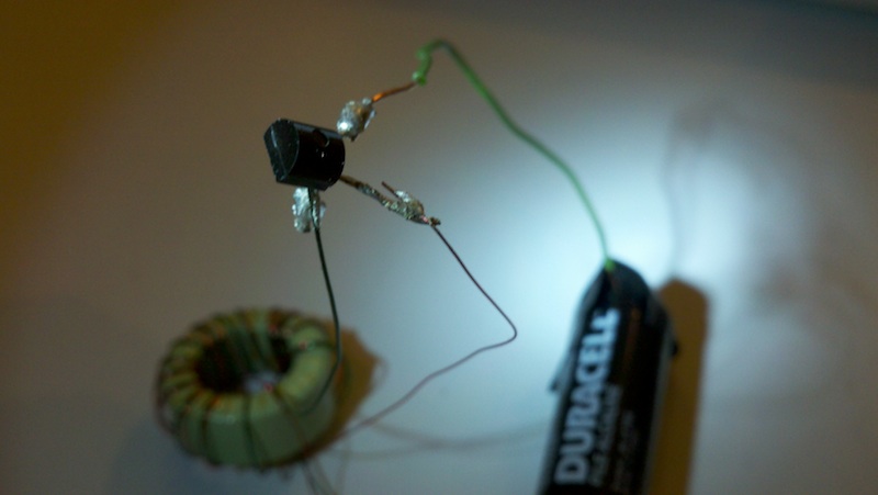

    I'm still stumped on how to do this. Attached is a photo of the circuit I tried to put together based on NickZ's post. I've tried wrapping the toroid with ethernet cable 100 times, magnet wire 10 times, swapping around the wires, tried different transistors - you name it, I've tried it. I can't get anything to magnify the input voltage. I'm getting 1.48 volts from the AA battery that is connected at the transistor connections, so I know current is passing through the wires. Can someone post a video or something to spell it out for me? So frustrated on something that should be so easy.

    • Hi br0ns0n77,
      I made a few of them based on this site. One thought I have is that your toroid looks a little large. I bought a pack of them at Radioshack and they seem smaller than the ones in your pic.

      • BrOn:
        First of all, the circuit that I'm using is not meant to be used with an AA battery, as it will cook the transistor. So, the idea was to use a resistor-less circuit that would work with these cells, and have a very low draw. As most Joule Thief circuits will not work well with these low current cells.
        Second thing is the toroid, which looks like it is made of iron powder, which have very low permeability, and in order to get those to work, you have to fill them up with windings, not like you have there. Best thing is to use a toroid with ferrite core instead. The small toroids that come in the CFLs bulbs work fine.
        Third thing is the solder looks like "cold solder", so I would re-solder your connections, to be sure, and be sure to use resin core solder wire or acid flux.
        Not all transistors work the same, even of the same kind, or even bought from the same source. So, try another one, I use the Kn2222A, and place a 1k resistor on base rail (center pin), to protect the transistor from it overheating, if you are going to use an AA battery. But, no resistor is needed if using these cells, instead of an AA battery.
        Other than that I can't see well enough to suggest something else.
        In any case you might start with the suggestions above.
