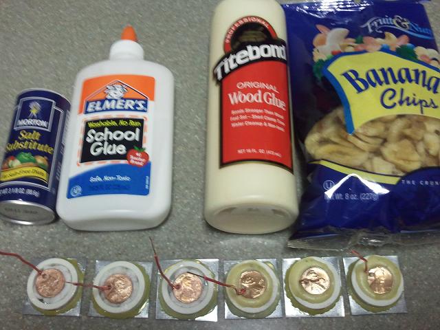

      I made 3 test cells with potassium chloride and white glue, also 3 test cells with banana chips and wood glue. Checking the voltage and current 3 hours after construction yielded the following results:
      Potassium chloride/white glue - 0.718 to 0.749 volts and 4.8 to 5.5 ma.
      Banana chips/wood glue – 0.881 to 0.922 volts and 2.3 to 3.2 ma.
      Now, the really interesting part: the potassium chloride and white glue behaves just like the cement cells and other glue cell I have built. When short circuit is applied the current drops as well as the voltage. The banana cells did not do this, when checking current with short circuit – the meter goes directly to the reading and stays at that reading. When switching back to voltage, the difference is negligible from original reading. What is it that is allowing the ions to travel uninhibited through the dielectric polyvinyl acetate (wood glue). Is it because the banana is organic or is there an element or combination of elements allowing this?

        Neat little test. What that may prove is that the banana is a better conductor of current as it may contain natural salts, minerals, or additional salts to keep the chips fresher. Hard to tell. If nothing is added to them, they would rot it time.
        Wood glue is made from milk which also contains a high percentage of water, minerals, and other things as well, that are trapped inside, and are not able to totally dry out, especially in a few hours.
        The real battery is in the copper penny and the aluminum foil. But the reason that the current stays steady on the banana cell is very, very important to know. Please exclude any salt on at least one of your tests, as we already know what will happen using any salt.

          Glad to see that you tired the banana idea. As for the Potassium chloride and white glue cells yes they do act like the concrete cells but try adding Epsom salt to the mix. I find that making potassium chloride, white glue, Epsom Salt cells to hold their voltage very well from when made to when dried.
          As for the banana it is the ions, the ions have been key. The organic banana emits small amount of radiation which is the ions. I would love to know how you went about making these cells, I didn't expect banana chips but they seem to be working fine. If banana works try mixing some mashed potatoes to the mix.

                There are probably many ways to build this test cell, and probably better ways than I chose, but this is what I did. I took the banana chips and ground them up in an old electric coffee grinder. Mixed 2 parts wood glue to 1 part banana, added a splash of distilled water to get a smooth creamy texture. Preheated my toaster oven to 350F and cooked the mix for 10 to 12 minutes, stirring only occasionally. This resulted in a very thick paste. I used galvanized sheet metal and a pre 1982 U.S. Penny as the electrodes and a ¼” tall pvc pipe for the form. Poured the banana/glue mix into the form and let it cool. After 24 hours the cells are still showing the same properties I stated before. There has been a slight drop in current, but not enough yet to worry about. This may be premature, but have you developed a cap/battery charging circuit yet? If so, would you be willing to share?
                NickZ:
                I looked at the package ingredients: banana, sugar, coconut oil, and natural banana flavoring. The nutrition facts state 0g Sodium. I did not add anything other than glue and banana chips. I should have used aluminum as it has a better electronegative difference than copper and zinc.
