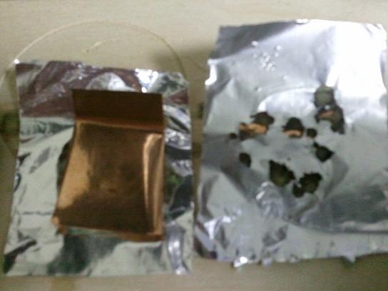

          When NickZ suggested aluminum as the electrode on the banana cell, reminded me of some experiments I did a while back when trying to see how quickly the anode would be consumed using different electrolytes. Aluminum foil from the local dollar is extremely thin. I made these little test cells from wood glue, potassium chloride, and a couple of copper sulfate crystals. The original output was around a quarter volt and a 2ma. Less than 24 hours they were dead and this is what they looked like.
          Brad S

            Copper sulphate degrades aluminum at an amazing rate.
            I am builder by trade and when they changed treated lumber from arsenic based to copper sulphate (ACQ lumber) we were still wrapping posts with painted aluminum. Within hours we watched the holes appear in the aluminum. This only happened on the extremely wet lumber.
            I am not sure how much a couple of crystals amounts too but I am sure that before your glue dried you had already started a rapid degrading of the aluminum.
            Not to say your not making a valid point just adding a little fact I know to be true.
            More than likely this process would been slowed down had you first coated the anode and cathode before bonding the 2 together with the blend you used.
            Matt

              Thank you for the confirmation on the copper sulfate (sulphate) Matt. I intentionally added this to the mix with the other materials thought to not be galvanic to show how easy it is to test. I should have made a comparison cell without the copper sulfate for reference.
              Thanks again Matt.

                I think that even if we don't use water, the same thing will happen due to the oxygen present in the Air. Alum can also be one of the causes of the deterioration, even though it is supposed to control it instead. A Neutral cell would be best. As it is the difference in potential in the two metals as was just mentioned again by Lidmotor, that is creating the voltage source, and not the salt, water, or air. Salt only further improves the current, but does so at the expense of the metals. The rest of the story is why or how the two different metals can create any voltage in the first place, and that is really the important point. As just to say that is it a galvanic reaction, does not really explain where or how the electricity that is generated comes from. Or does it???
                These cells really should be using bigger and wider plates inside, instead of wires as the electrodes. As current and voltage output is dependent on the mass and surface area of the metals. That way we can catch up to the rest of the current battery industry and its related technologies.
                As far as I can see so far, it's the oxidation and the loss of physical contact in the cells and wire connections causing the problems.
