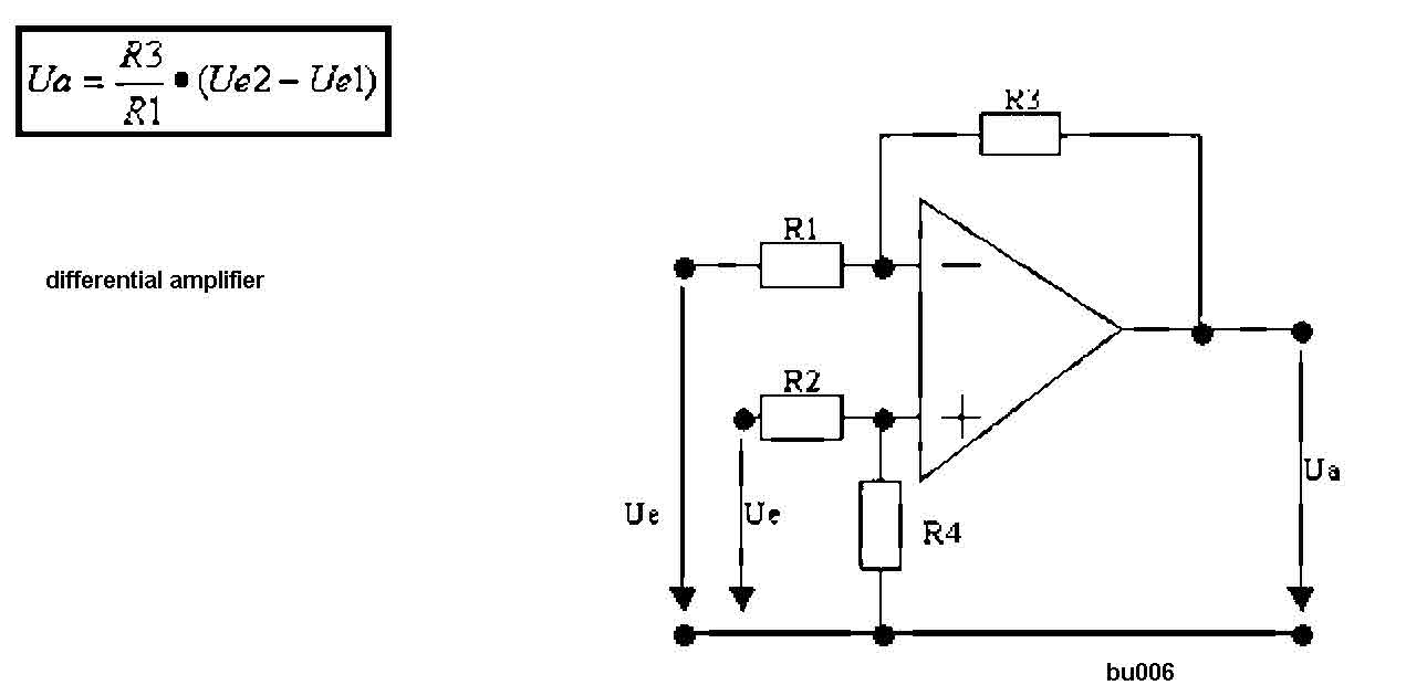

      Looking at OPAMP A24 at Figure 4 it seems to be a differential amplifier: Operational amplifier - Wikipedia, the free encyclopedia
      At the non-inverting input (+) there is a constant (adjustable) positive voltage.
      At the inverting input (-) there is the (slowly) variable positive voltage from the voltage follower A25 from system control J. C4 seems to be a low-pass filter element (bu007) added to the differential amplifier (Introduction to Filters )
      To get it right in bu006 there should be R1=R2 and R3=R4. The amplification factor without these resistors would be much too high. So the amp factor is determined (reduced) by relations R1/R3 and R2/R4.
      So my best guess for C4 at Figure 4 is to start the circuit without C4 and to test the circuit dynamics in operation starting with the following caps: 10µF, 1µF, 100nF, 10nF,1nF, 100pF and to meter the circuit dynamics.
      The relations of resistors at bu006 must be transposed at Figure 4 to (P3(fine adjust)+R2), R4, (R5+P4(fine adjust)+R6).
      The value of R1 at Figure 4 depends on the behaviour of the Darlington Circuit Q4 Q5. Starting with R1=0 ohms gets an amp factor of 1, higher values get a higher amp factor.
      For R3 at Figure 4 I would start with 1 MOhm.
      Notice: A24 makes a signal inversion.
      Greetings,
      Bussi04
