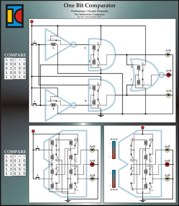

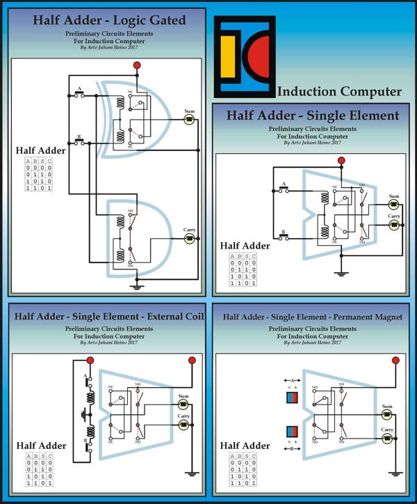

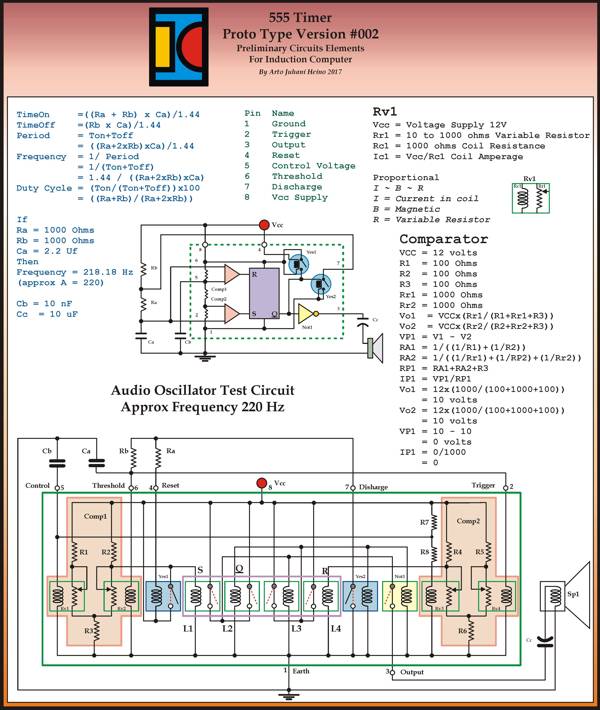

Hi ALL,

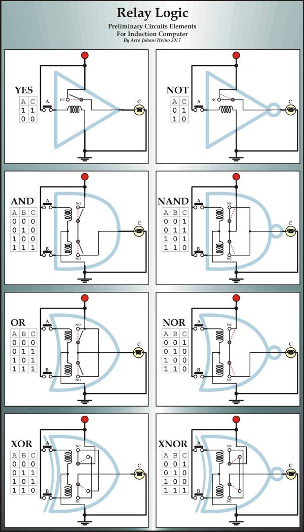

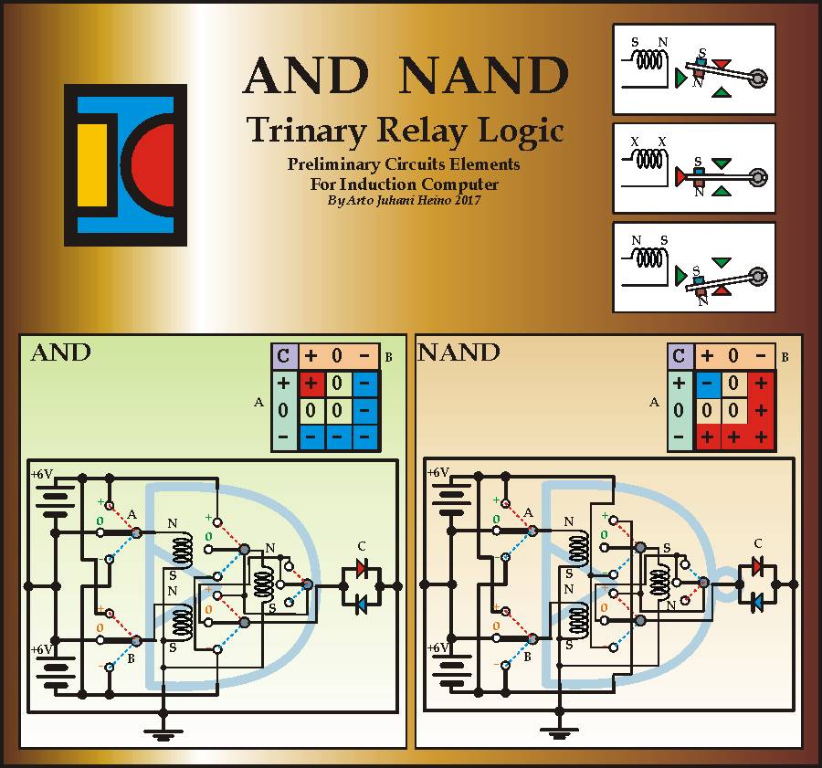

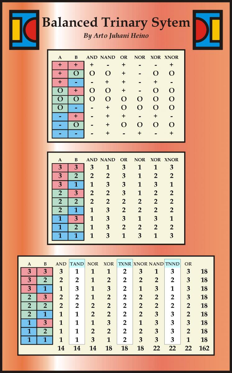

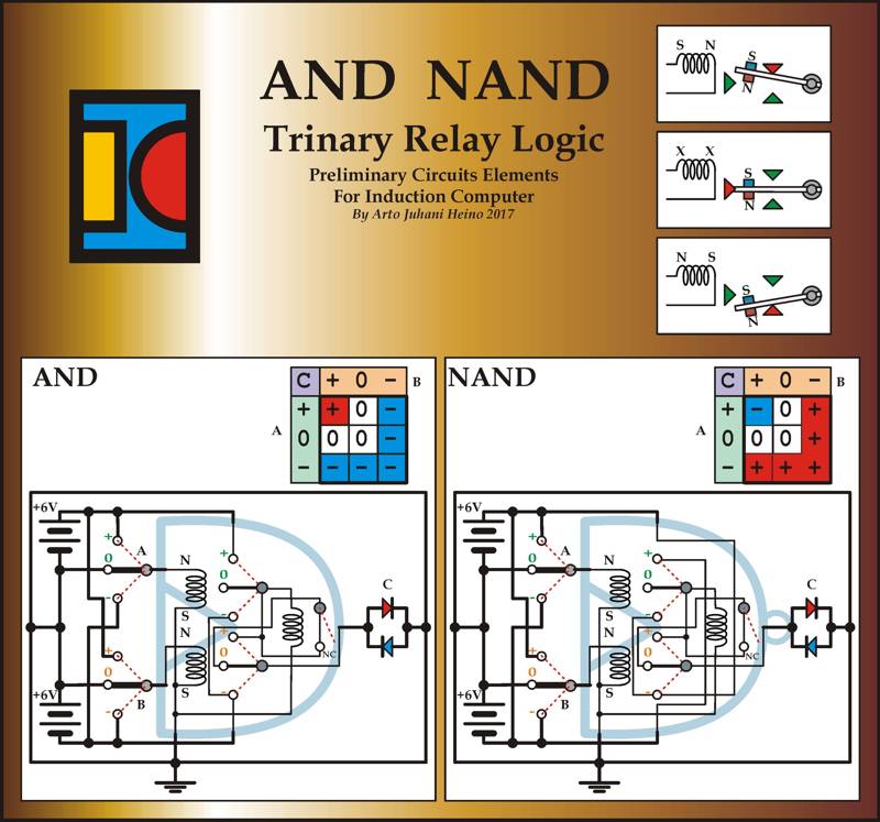

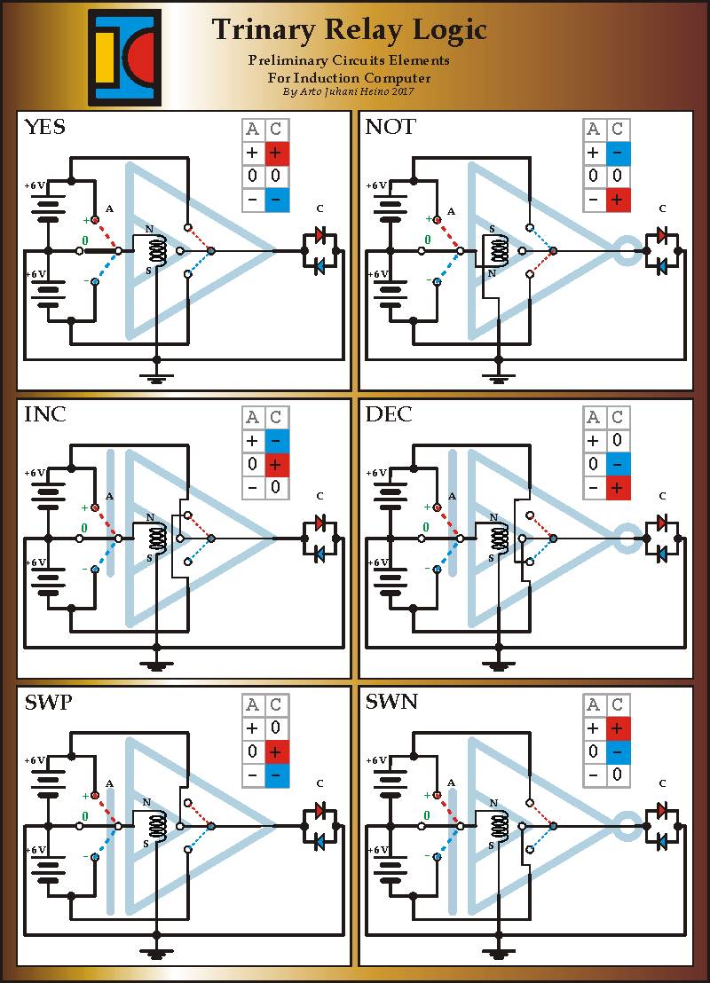

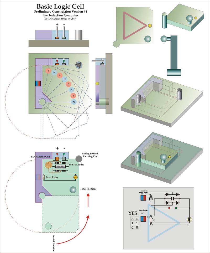

I am posting my work here, mainly to see if people are interested in Relay, Magnetic,Electrostatic or Acoustic Computers in Binary or Trinary, in the old style of relays and commutators. I am carefully moving towards building it from granite and running it from an acoustic input.
Here are a few pics along the path of rediscovery.
