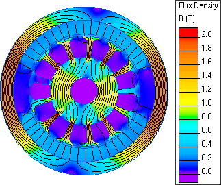

Beg to differ. Take for example a DCPM motor, PM field stator with wound armature rotor. Like the Imperial from Ufo's Asymmetrical thread. The backiron is the outer steel tube and has a static (unchanging) magnetic field or flux in it. There is zero loss in the backiron.
Similar example. Magnet stuck to refrigerator. Magnetic field (flux) from the magnet completes the path through the steel panel on the fridge. Does the steel panel get hot? Is there power loss in that magnetic circuit (magnet and steel)?
Most all the typical motors (excluding transverse flux and homopolar) are double air gap machines meaning they do use both a N and S stator pole, both facing the air gap, magnetically connected through the stator by the backiron.
