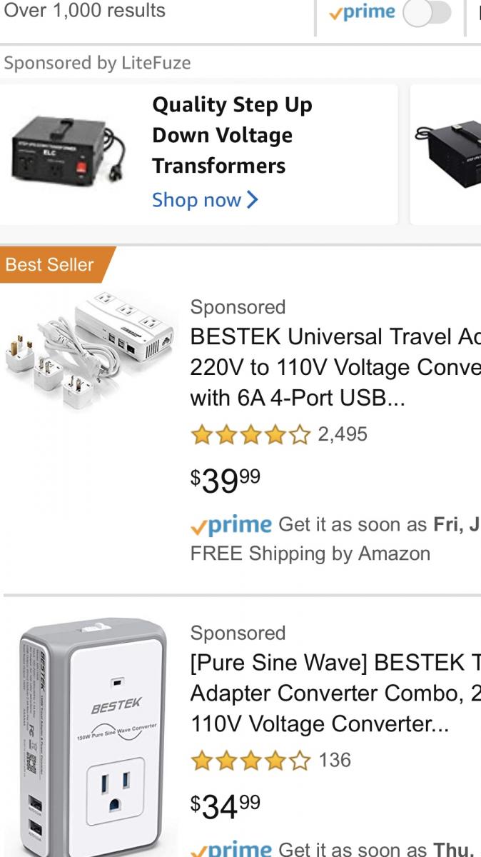

      Ok
      Maybe not?
      Look at some manufactured
      items and there entire build.
      Is there anything that works
      into your area of build?
        So basically they work with almost the same circuits and they don't even give the high current (36A) i need. I think my idea is better and cheaper than buying from ebay. Less problems to face....
