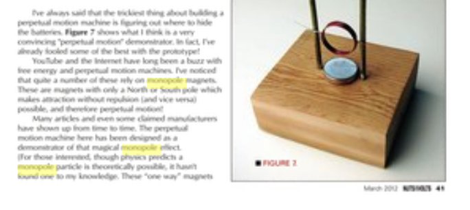

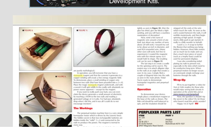

              FAKE!!!
              Come on guys do a little research before posting this stuff.
              I found the pics showing how it is faked and if you can read the rather fuzzy text it says how. Without buying access to that site I couldn't get a better image. This is from the guy who made the video. He's an inventor - that is inventor of magic tricks and illusions.... LOL
