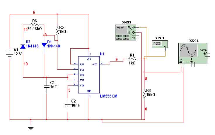

    Hi All
    I have made two alexkor battery charging system circuits on chapter 6, pag29-2SC3552 and pag26-IRF510 (http://www.free-energy-info.com/Chapter6.pdf).
    The first works well, i used 3 transistors.

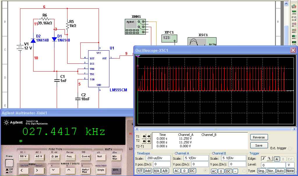

    But the 555-IRF510 model does not work very well. I played around with the frequency in the Multisim11.
    I noticed a difference in the frequency:
    With resistor 39.16K = 27.44 kHz
    With resistor 30.16K = 35.32 Khz
    May be a mistake?
