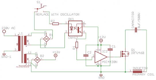

    Is there any electronic expert here ? I have composed schematic with optocoupler and mosfet driver and I very appreciate if somebody corrected it and posted if that makes any sense ?
    I try to completly isolate oscillator section from mosfet because I want to dump large capacitor 8-30uF via 2-4 mosfets in parallel at 440V to low inductance primary and that would be quite dangerous
    Attached is simplified schematic when oscillator is just replaced by a switch.
    Please help.
    Especially I don't know if 500V GND should/could be connected with mosfet driver ? How to pass signals sent to optocoupler to the mosfet driver side ? I just connected phototransistor inside optocoupler via resistor to +Vdd (12V) Is that correct way ?

      I checked the data sheet for your mosfet driver and it looks like you have everything drawn up properly. I would make R1 and R2 about 1K to start with to limit the current and see how everything switches. If you do not get full on and off like you want you can try lowering R1 a little and then R2 if you need to. I would not go lower than about 100 ohms on each of them because you could burn out the opto coupler or the mosfet driver.

        Oh! Thank You Carroll ! You have given me hope that I could cope with this enterprise
          Question arise : how can I check if mosfet is fully switching on/off in this schematic ? I have no experience in checking this, previously I have just built circuits from schematics but now I have old analog scope so maybe I can use it...

                Every MOSFET's must have a Bias to opposite polarity from its Gate, whether an N or a P Channel, this is done through a resistor, like in my original oscillator it had a 47K Resistor from gate to ground on each FET, they were N-Channels, meaning Gate is Positive, therefore triggers (Close Drain-Source) at Low Oscillator signal, the Bias resistor will "call back" to reset position (Open Drain-Source).
                I believe this Biasing of Gate is your way to keep the Low circuit from the HV at Drain-Source. You must have two ISOLATED supplies, one low V for oscillator and opto-coupler and the HV (Vcc-Vss). Therefore, the bias resistor to gate should feed from the Low Voltage ground. I believe that will keep Gate isolated from D-S circuit.

                    If you can get an SG3524 chip in your country you can use that to make a circuit that will give you an almost perfect 50/50 duty cycle. You could then use the output of that chip to control the 555 chip using pin 4 of the 555. This should let you have full control of the frequency of your pulses and control of the on and off times too.
                    You asked about your circuit if you needed to keep the ground from the 500 volt side connected to the ground of the mosfet driver chip. Yes you do need to keep them connected together so the mosfet driver chip can have good control to the gate of the mosfet.
                    If you have a probe for your scope that has a 10x position you can probe from the source to the drain of mosfet to see if it is turning all the way on and off. Put the ground of the probe on the source and the hot side of the probe on the drain. If you don't have a 10x probe you can check at the gate and see if you are getting almost the full 12 volts at the gate when the driver chip is turned on. If you are getting the 10 or so volts at the gate when turned on then the mosfet should also be turning fully on. Again just put the ground side of your probe on the ground of the circuit and the hot probe on the gate. Hope this helps some.

                        Opto-couplers are orders of magnitude slower than BJT/FET/IGBT
                        For example:
                        Code:
                        Parameter    H11D1    IRF610
                        td(on)         5uS        8.2nS
                        tr               2.5uS      17nS
                        td(off)         6uS        14nS
                        tf               5.5uS      8.9nS
                        E= V^2*C/2
                        30uF @ 550v is 4.54 Joules, you could probably scale that up a bit
                        However, if your inductor is lacking impedance, your switch might be seeing 550 Amps at t=0 and ~10 Amps at t=120uS... Yeah.. most silicon switches affordable to hobbyists aren't well suited to capacitor discharge.. mmmmmm... Thyratrons .... :drool:

                          Thank you.Yes this is what I'm afraid of. My coil inductance is low ,don't know how to avoid the initial current surge especially if switching frequency will be low ,probably in Hz range because I have also 11H choke coil which will recharge capacitor every cycle. I have no big hopes but I would be happy if I could make it working ....
