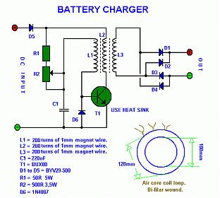

    I have a few dead 12 volt automotive batteries, and I would like to see about building a radiant battery charger to charge them, if that is possible. To that end, I am requesting that you please post any information that you have on radiant battery chargers to this thread.

    This one worked for me - good desuphator and charger. Produces nice voltage spikes which have their own interesting effects:

        Yes, that worked for me too.
        Groundloop at ou.com has done a good job.
        I was able to charge a motorbike battery with this schematic more than just a few times
        from a battery charged the conventinal way, and it discharged 1-2 volts
        and not more.
        The only exception in my version was the transistor I used.
        I used BD243C type.
            and not more.
            I used BD243C type.
            tHIS IS MY FIRST RADIANT CHARGER works great on my 60 ah batteries
            the simplest design ive made thanks to Groundloop 5 stars
