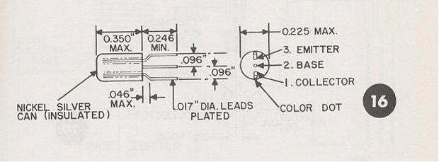

                              • 2n108
                                I see a few of these links are repeats from post #2844,
                                I left them in so they would all be together in one post.
                                2N108's were a CBS division part number
                                for a bipolar PNP germanium transistor that were
                                commonly replacing tubes as the audio output stage
                                of portable radios like this.
                                emer843
                                Note the 1st, 5th, and 7th pics for case style used then,
                                don't you love the phenolic inline style sockets ???

                                The army used this tester to test them,
                                the 2N108 is listed in the spec sheet...
                                They are so old they were originally packaged with
                                inline leads (Right pic below) until the newer style
                                triad lead packaging was implemented later (Left pic).
                                2N108 Semiconductor (Transistor, diode, IC) Cross reference
                                Left = "Triad" (Newer) layout:
                                1 = E
                                2 = B
                                3 = C
                                Right = (Older) inline layout.
                                Hope this helps somehow...
