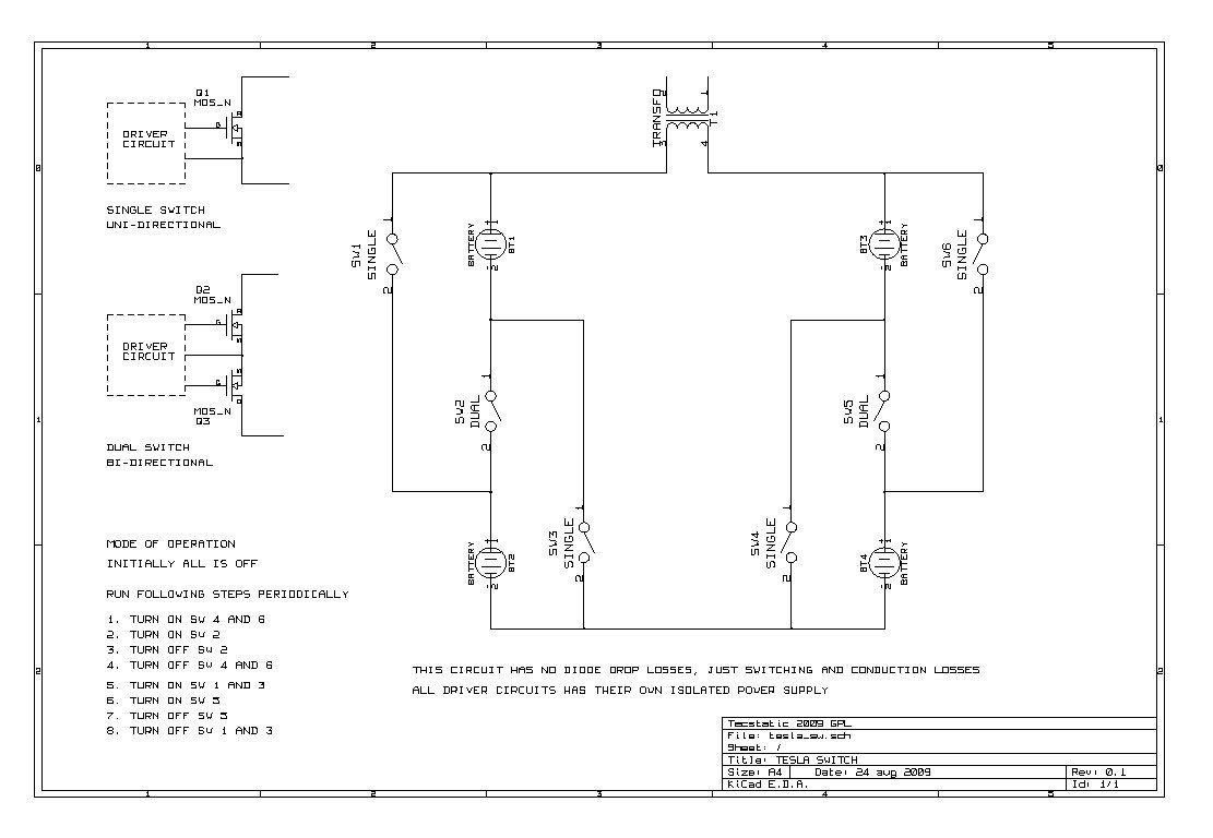

For those of us who've spent years poring overOriginally posted by DoubleD View PostCan't get it much simpler than in the sch I posted just LOOK at any one of the 6 fet and drivers
2 diodes, 1 driver one fet .
2 caps one for noise one to de couple
1 resistor from driver to gate and 1 diode for faster turn off.
Each driver fet combo only SEEs the battery it is switching.
The Boost for the High side drive is from the SERIES Connected bank on the other side so it is ALWAYS available without all the BS involved with bootstrap ccts that don't work worth a crap in this reversing type cct.
Pretty simple actually if you just look at it Just one simple design applied 6 times cept for the little tweek for high side. that also will FOLLOW the voltage being switched. In other words there will ALWAYS be the required 18volt above for the gate regardless of the voltage being switched.
Power for the Control cct is Floating from ALL batteries too so there is no reference to any single battery and it's associated noise etc either.
OK Your Turn !!
Now lets SEE YOUR DESIGN to do the same.
Curious to see how to do it with Transformers.

Well I usually don't do schematics for MY stuff as it is an extra un-necessary step for me most of the time.Originally posted by SeaMonkey View PostFor those of us who've spent years poring over
schematics it is not beyond our ability to track
and digest. For those less able and experienced
it is an imposing diagram. '
NOOriginally posted by SeaMonkey View PostCould you possibly think of a way to simplify the
visualization by means of an altered layout to
better emphasize what your strategy is? '
If you can't figure it out with this then Sorry, .... I have lost my crayons.

A Blast From the Past
The circuit which Eric posted some time
ago is conceptually very sound.
Apart from the polarity of the circuit at
the "Load" terminals with respect to the
battery banks, it is so very close to a working
implementation.
The notation regarding the method of supplying
power to the various drivers is pertinent.
Whatever has happened to Eric?

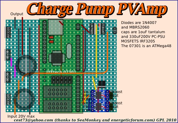

meantime (sideshow progress report) news flash
The progress of the TS PVAmp with MOSFET and nsec ragne "Que":
I have soldered the power-stage (IRF3205 55V failover, 53A DC, 150A surge) and the Schottky diodes (MBRS2060 60V, 20Amp DC, 150A max surge) and started to layout cables.
The sketch is roughly this (there are errors and inconsistencies yet, but it is "very about it"):
(soon to be continued...)
Vissie ..
