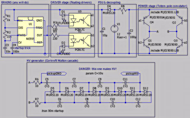

        • trading V for A and back
          this is somewhat out of topic, but it has to do with 555 and the PV_amp as it is aligned to the concept of trading voltage for amps and vice versa.
          Interestingly, there is no trace of heavi amperage load all the while producing HV:
          I just post it in advance before i go to H/W with it ( an sort of a battery poker )
          Leroy, Tesla did imagine impedance as springs:
          Code:
          a small capacitor is a stiff spring
          a large coil is a soft spring
          there from he derived conclusions on oscillatory electricity motions...
          Now we all know we have those transverse springs (like fishing sticks) and longitudinal springs (like in the ball pen)...
          (uh, oh... i left my thinking cap too long on... )
          Ah,
          The schematic
          P.S.
          what if we substitute he capacitor array with batteries?
          no?
          P.P.S.
          its based on this:
          Cockcroft-Walton generator
          • Did I say it goes atop of 80V?
            It would need to have a scr/neon trigger (crowbar type) for kicking whatever ...
            Stevan C.
