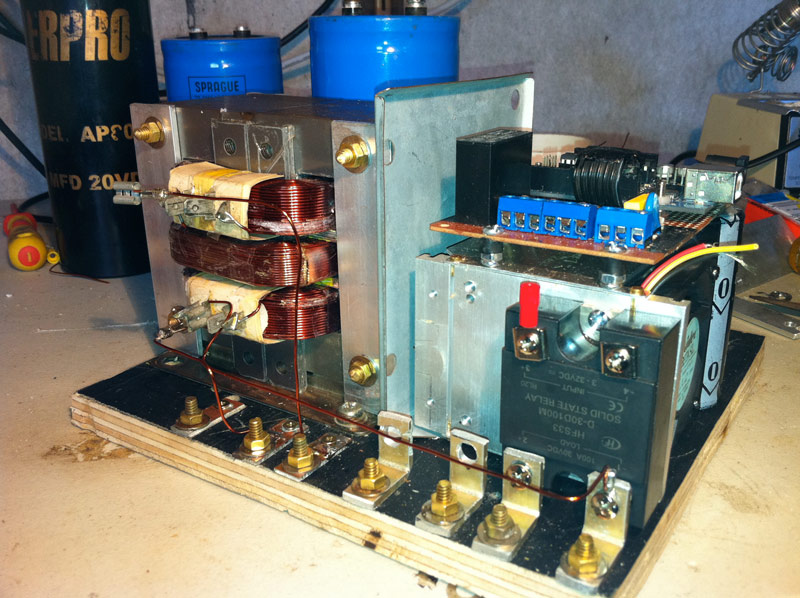

Here is a photo of my first Tesla Switch build.
I am using Arduino and HFS 30v 100A SSR's.
The re-assembled MOT has a MOT primary on the top and bottom @ 4 ohms, 150 millihenries, the middle MOT primary is from another model and thus reads slightly higher in resistance and inductance. So not ideal, but not too bad for not having to wind a thing. It will do for a first build. I already shorted the setup through the transformer manually and it fills a cap up nicely off the secondary.

Thats a nice build Ren.
One suggestion make sure you put some some big high voltage diodes across those relay's even if they are already incorporated into the relay. Those relays don't take to any transient behavior.
I can't wait to hear the results. Take your time and make sure you get it in tune before you start to measure.

I originally wondered why you chose to place the switches like that, I thought that maybe you placed them where you did in an attempt to isolate the switches somewhat from the inductors. But, as we know, that spike will find his way around your circuit till he pops something.
So 1n5408 (?) will do, in reverse over the +/- terminals, or do you need something higher in current or speed?

Ya that will do. Its just "Incase" thing. Like I said the Hong fa's are very temperamental. They won't put up with much. You might run that thing 100 times then POW, no switch. I have used them alot.Originally posted by ren View PostThanks Matt,
Ren
