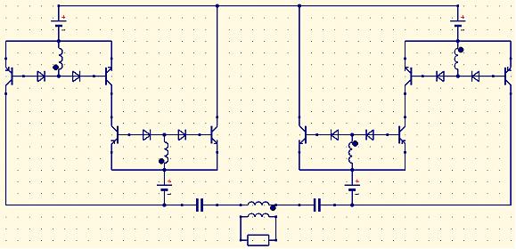

            • Its running!
              I just got my TS going.
              Jump-started it with an oscillator that i later removed.
              Its self-oscillating at 570Hz with an iron-core, goes higher with air-core.
              One of the 12v batteries jumped up to 17.37v, probably one of the low ones.
              The load is a 5v lamp glowing although not very bright.
              I'm taking notes on the battery levels.
              Schematic below, each transistor also has a diode across collector and emitter to capture the spikes.
              Edit: and there are no caps.
              /Hob
              Hob Nilre
              http://www.youtube.com/nilrehob
              • video

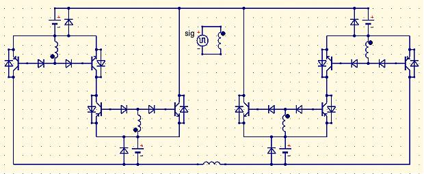

                • new run
                  I think one of the solderings where bad and it made the first run go not so well
                  I have now added some diodes across the batteries that I'd forgotten and also updated the schematic below to include the new diodes and the diodes across the transistors that where already there in the first run.
                  Its not self-oscillating anymore. The original 6-filar coil is now only used for triggering, 4 windings to trigger the transistors, one for the signal-generator (and one for measuring).
                  As a load i currently have a big coil, nothing else.
                  The signal from the signal-generator is not a square-wave going just pos-neg, but rather a pos-zero-neg-zero signal allowing the big load-coil to discharge when the signal is zero and all transistors are off.
                  By adjusting the frequency on the signal-generator i think i now have a state where it actually works like a swing, pushing the load-coil at the right moment, never colliding when it swings back.
                  All batteries are now going up slowly, but its too early to tell why

                        • Nice work Hob. Thanks for sharing your schematic and videos.
                          I'm thinking that I'm going to try using diodes between my coils and transistor bases like you have done because I was seeing triggering at the wrong time during my initial experiments. (But I'll also have to wind a new coil now so as to compensate for the additional voltage drop across the diodes.) I was seeing the transistors turn on momentarily during both leading-edge and trailing-edge of my pulses. The diodes should remedy that.
                          Thanks for sharing your results. Keep up the great work.
                          • @nilrehob
                            Do you think its possible that the signal generator is introducing energy into the system even though or especially because, it is attached inductively?
                            Would there be a way to isolate the 2 components from each other?
                            You understand why I am going there right? Thats where the critic would go.

                              I keep the NPN/PNP/2+2-doides as a module, 4 of them in the TS, very handy in all kinds of setups.
                              /Hob
                              Hob Nilre
                                No, i wouldn't think so.
                                The current induced from the SG is "trapped" in the coil-diode-base-emitter-(and back to coil)-path and never reach any battery or the load.
                                Tough call.
                                Better to power a mini SG from one of the batteries or as a part of the load?
                                (Edit: by SG I mean signal-generator, not a midget schoolgirl)
