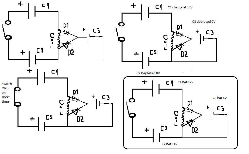

    Hi folks my next setup is on picture
    setup is :
    C1: 330uF 200V
    C2: 330uF 200V
    C3: 480uF 200V
    Coil is from bedini coil i use only power wire ,, triger is fully unpluged
    coil hat 850 turns awg 26 ..
    you can use transformer secondary or primary winding ...
    Start test :
    C1 charging at 25V from 2x12 bateries
    C2 hat 0 volts
    C2 hat 0 volts
    Switch on short time
    end test
    C1 hat 12V
    C2 hat 11V
    C3 hat 6V
    C1+C2+C3
    start 25+0+0=25V at 330uf
    end 12+11+6=29V
    "i think"
    when switch ON C1 charging C2 creating magnetic field on coil
    when C2 is charged magnetic field colabsing that create spike and charge
    C3
    + energy is .. captured radiant energy ?
    im inspired on this circuit
    free energy demostration, free energy experiment - YouTube
    pls im newbie maybee is fully mistake ..hmm
    mee english is so bad sorry ..
    Hi Powers, interesting experiment. I use a program called
    Electronics Assistant. link below, with it the charge in a capacitor can be
    determined. (If installing uncheck all options for new toolbars and stuff) if you
    don't want them.
    Download Electronics Assistant 4.2 Free - An aplication that performs electronics-related calculations - Softpedia
    It tells me you start with 25v in a 330 uf cap C1 = 103.125 millijoules.
    Then after you end up with
    12v in C1 = 23.760 millijoules.
    11v in C2 = 19.965 millijoules.
    6v in C3 = 8.640 millijoules.
    total = 52.365 millijoules.
    millioules left = 52.365 / 103.125 millijoules started with
    C.O.P= 50.778 %
    Strange how it works out but as the voltage in a cap gets higher there is a
    non linear amount of charge stored kind of thing. 6v in a cap is not
    necessarily half the amount of charge as 12 volts in the same cap.

      Farmhand is quite right, E = .5c*v^2 or energy equals one half capacitance times voltage squared.

          Indeed you are on good track
            You've lost some energy in the process, but gain charges. There is a way to turn those charges into higher energy. I believe it's call resonance. I made a circuit with falstad to show how you can add these energy. Hope the link works.
            Circuit Simulator Applet
            Yay, it works. Thanks Joit, this is a gift from God.
            Adjust the speed to slow it down or speed it up. Close the right switch at the right time to make the oscillation larger. This certain right time is crucial and determine how much energy you get for your charges.
