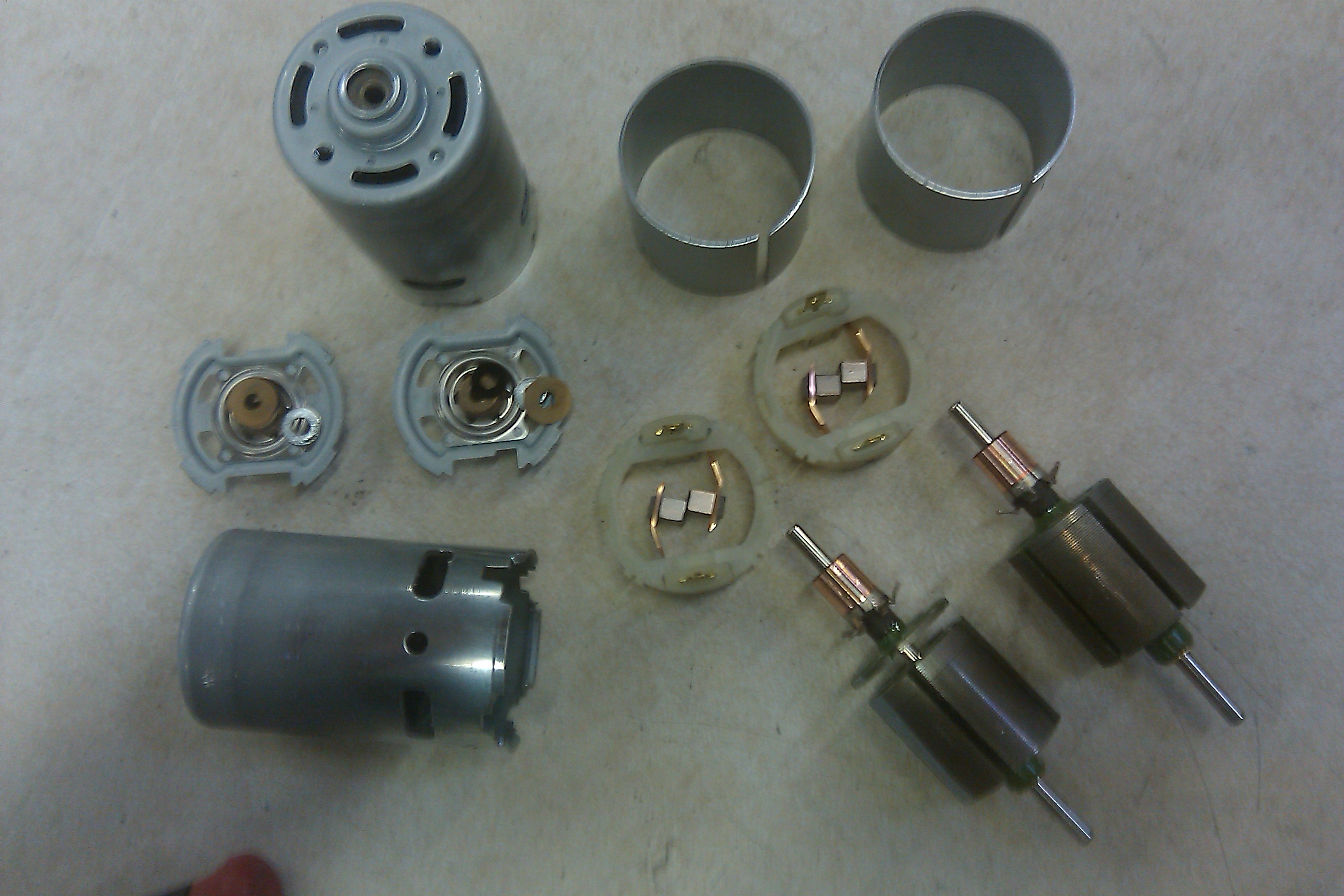

Thanks for all the info UFO, Great work on all the videos.
I purchased some similar small motors to the RS, although it maybe a little larger,
same five pole conf. and I am going to cut off the end of the second motor
and weld it to the first. (picture below)
The picture you posted, of yours, is a little vague on the windings, as it appears one
coil wraps on two poles.
I drew it out and looks like each pole has two windings around it, as left of one
winding and right side of the other winding.
CCW direction for us northern hemisphere.. Right.
Can you please clearify, for all of us.
Thanks, Mark
Hi Rl2003, the armature coil does wrap around 2 of the poles, then continue wrapping when done with that coil to the right or left, whichever direction you are choosing, start winding another coil over the next 2 poles to create the typical north on one end and south on other end.
These 2 coils are in series and will look like a pyramid or V shape when looking down shaft.
Hope that helps, as I intently studied all his videos and pictures and words.
